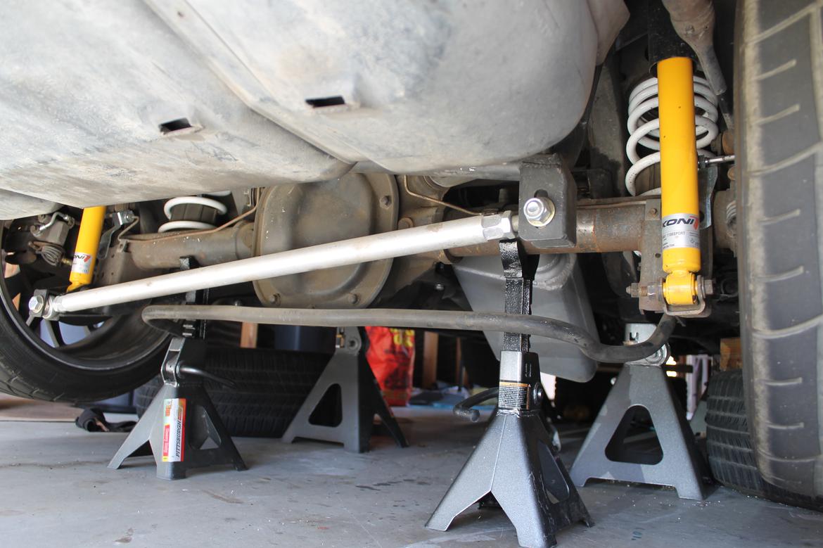

Next I tackled suspension:
  • Full length, weld in subframe connectors. (I honestly wish I had skipped these and done a cage instead)
  • Poly suspension bushings
  • MM caster/camber plates
  • Added MM Panhard Bar
  • Solid steering rack bushings
  • MM rear lower control arms (stock uppers)
  • HR Super Race springs
  • Koni Yellows

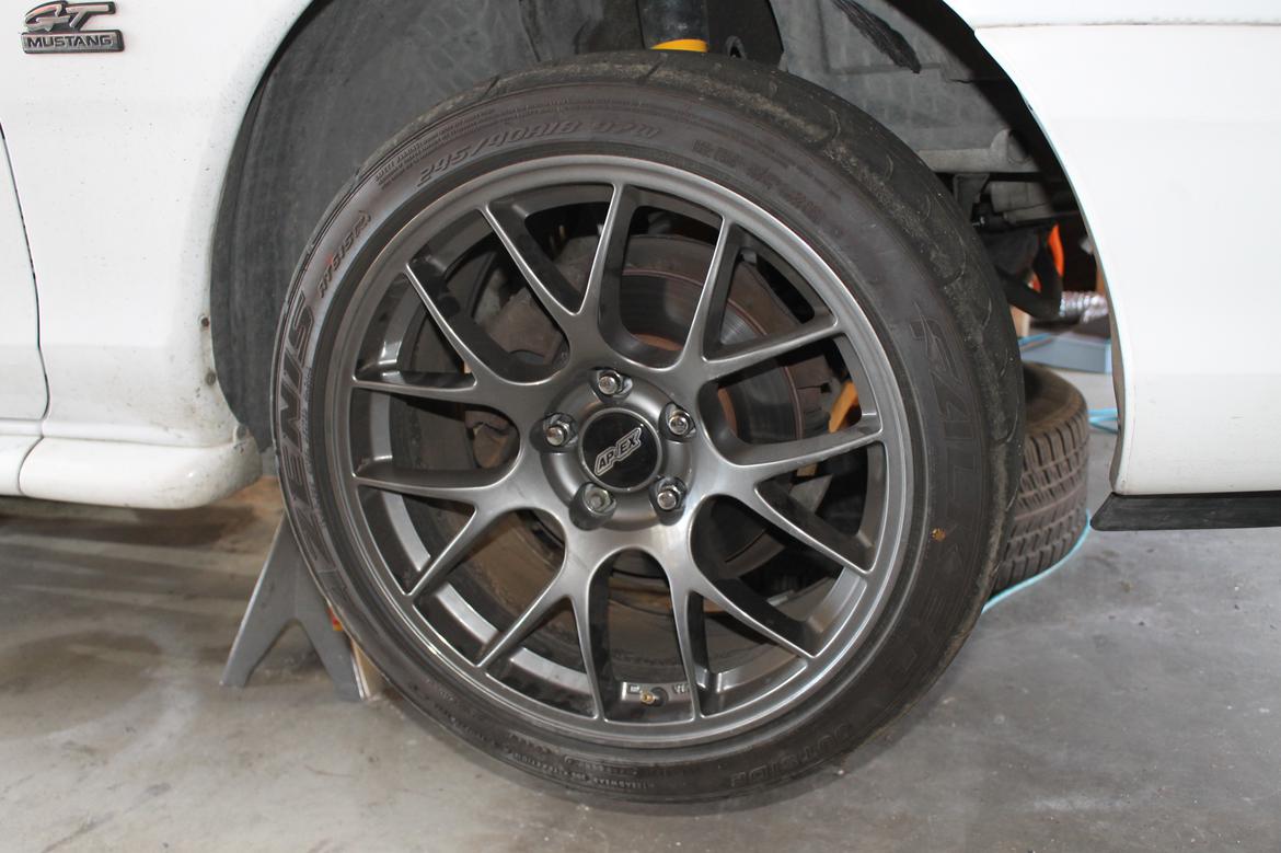

  • Apex racing 18x9 wheels with 245 falcon azenis

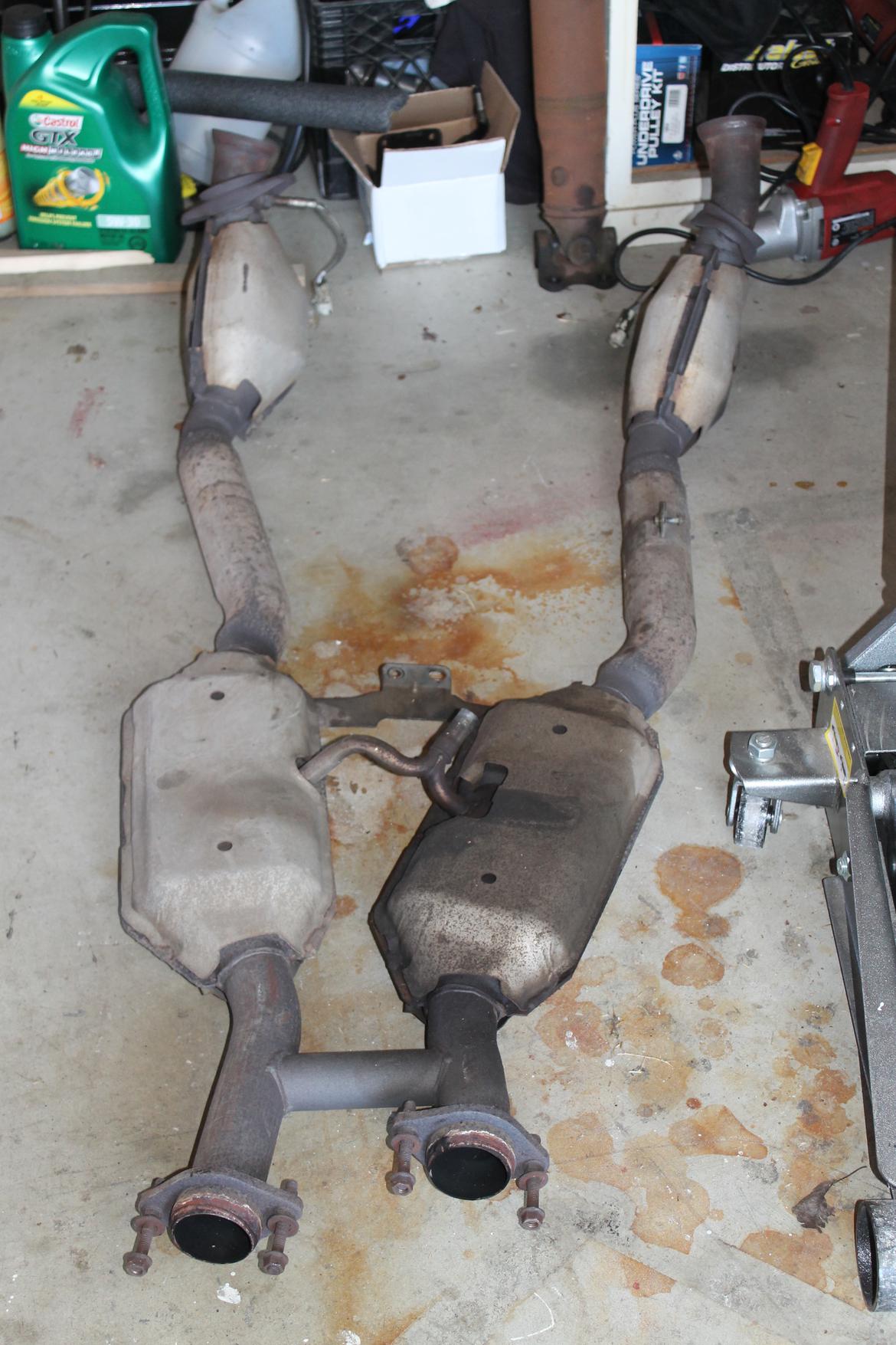

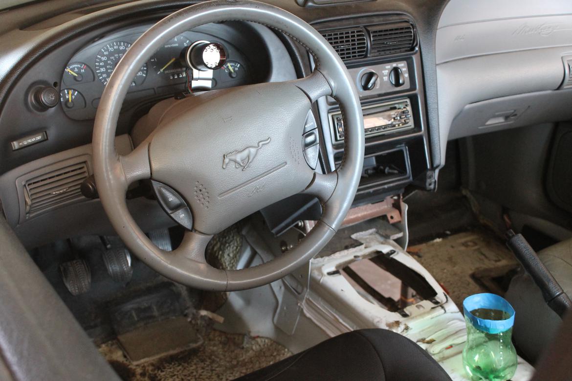

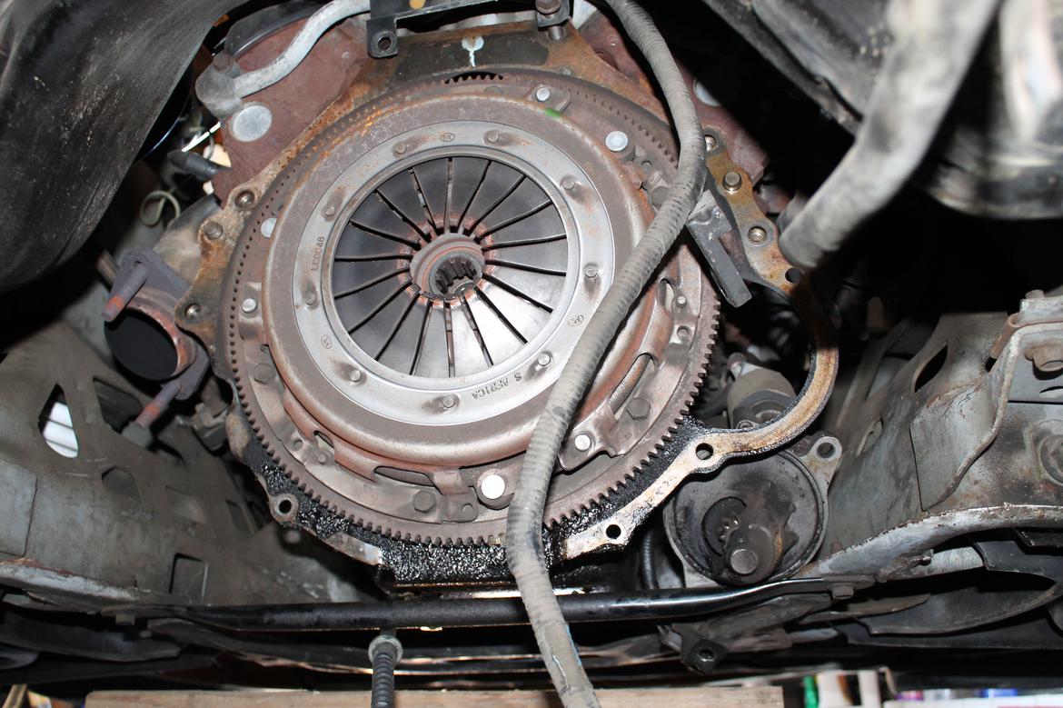

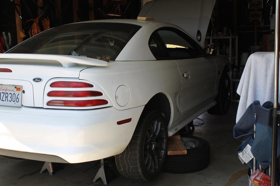

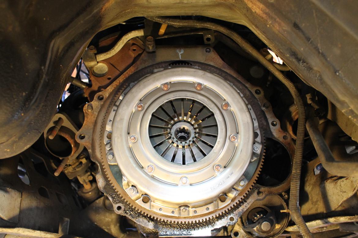

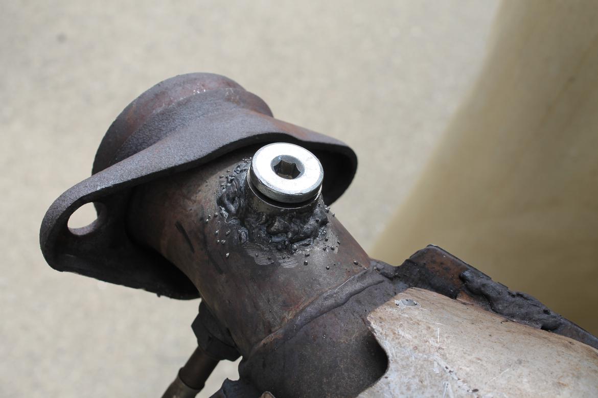

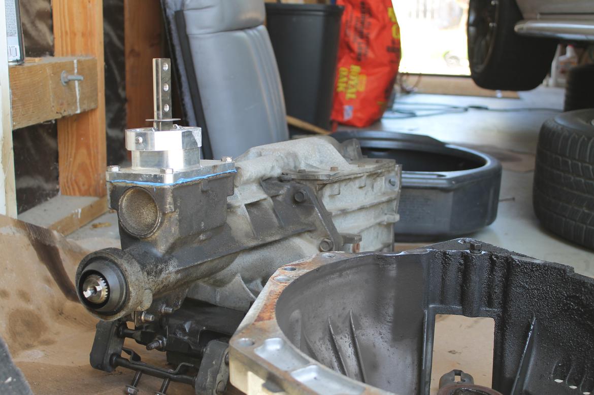

Right now I am taking half a season off from racing to change the clutch (and RMS, throwout bearing, etc) and rebuild the rear diff.  I work very slow most of the time.  Like 2 hours a week. Here are pictures of the current state of things.
(half a plastic bottle and some self drilling screws makes a good cup holder, even passes tech!)
(old clutch, not removed yet)
(four cat H pipe.  I will be adding an O2 bung for future use.)
Thanks to previous military jobs, I literally can't do anything with out a checklist.  I also usually write down everything I do step by step and then later follow it in reverse.
That's all for now.  I will ad pics tomorrow of what the clutch and flywheel look like.

careful with poly suspension bushings.  If you put them in places that move in multiple planes they can bind or even break things.  I’ve heard of a lot of these problems when put in the rear control arms.

I'm near Santa Maria.  I agree on the poly bushings.  The MM ones have poly on one side and spherical on the other. The uppers are stock.

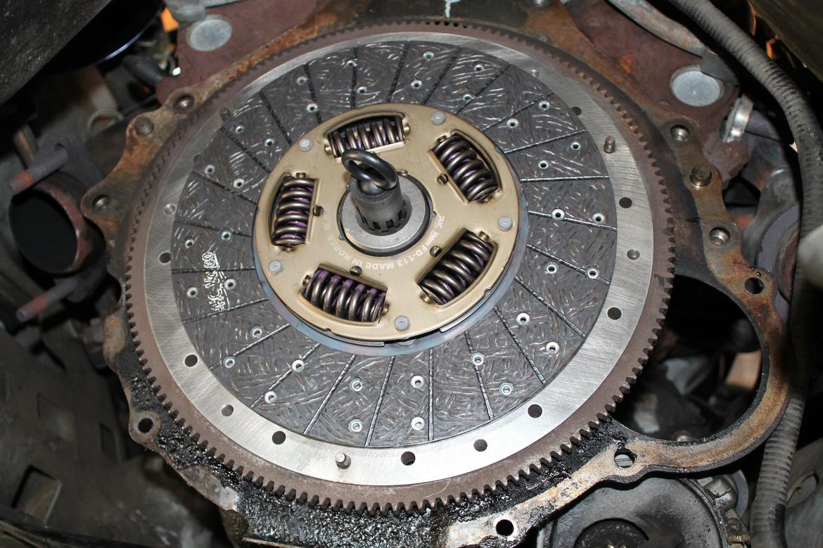

7/9/18 6:02 p.m.

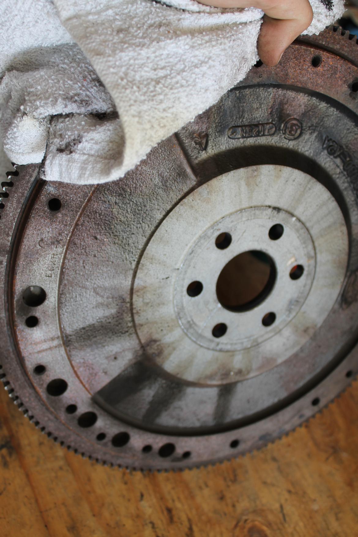

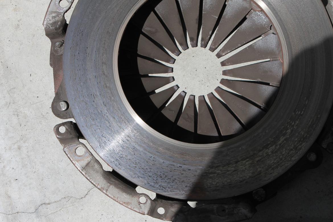

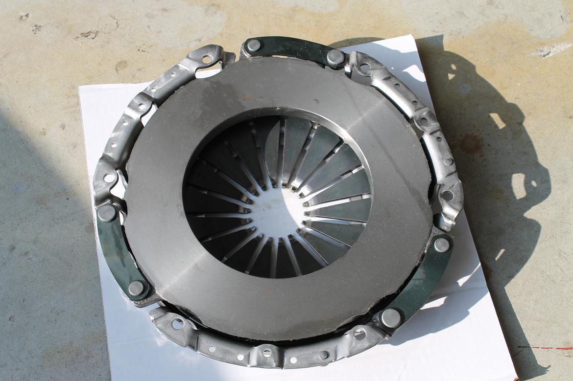

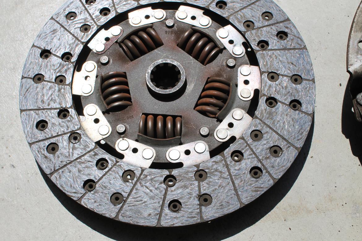

So I got the clutch off.  I don't have much experience with clutches, but these don't look that worn to me.  What do you think?  I will still probably replace it because I bought one that will hold more power than stock.
Also, the flywheel appears to be weighted on one side, but there are no markings on the flywheel or engine showing how to orient this when installing it.

i believe that flywheel will only go on one way (the right way), even though it looks like it could go on 6 different ways.  Since you've already got the old clutch off, i'd replace it, and keep the old one as a good spare (clean the friction surfaces up with brake cleaner and a red scotchbrite).  red scotchbrite or sandpaper on the flywheel to give it a clean surface to bite to.
nice build.

In reply to stylngle2003 :

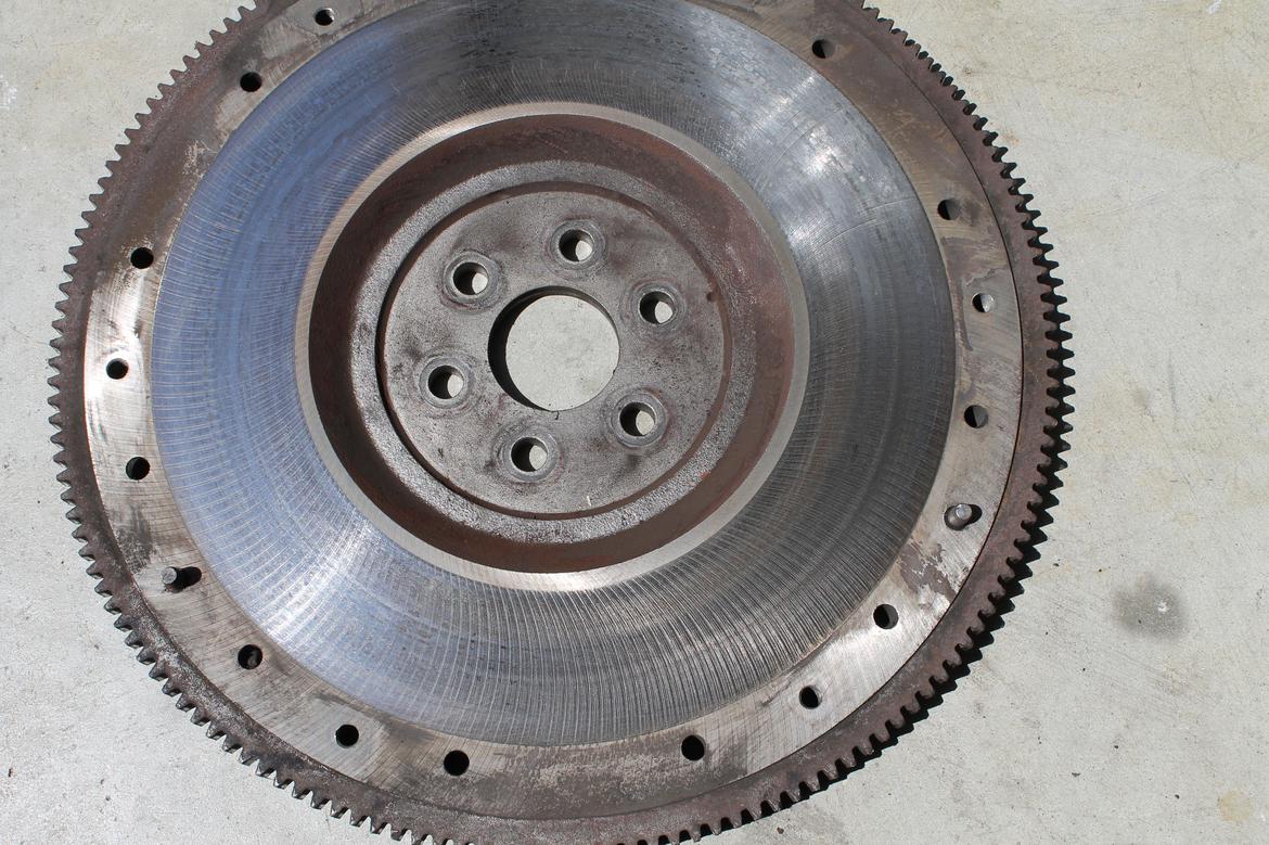

Thanks, that's good to know about the flywheel only fitting one way.  I think I am going to resurface it too, just to be on the safe side.  I have to call around to see what it costs.

Just a quick update. I have been busy with work and haven’t progressed much. I’ve booger welded an O2 bung into the H pipe just in case it ever gets boost in the future.

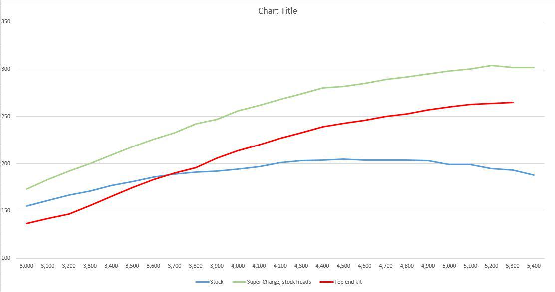

Well not much to update.  I am still waiting to order legal headers so I can be smogged and legal again.  In the meantime I have been debating throwing the above to-do list aside and going for more power.  The question is to do a top end kit, or a entry level supercharger on stock heads.  I have been having a hard time finding good data on the gains between the two options.  I finally found an old Mustang360 article where they made baselines using a mostly stock Fox, the same car with top end kit only, then the same car with stock heads plus a 9 PSI supercharger.  I always thought the top end kit would be better, but the chart below makes the supercharger with stock heads look much better.  I just put their data into a spreadsheet.

I don't doubt that 9 psi would work better on the choked E7TE heads on the fox more than a top end swap.  One concern would be how long would the thin deck E7 heads last with the boost?  I think you'd be replacing the head gaskets for a set of Cometics pretty quickly, so at that point does it make sense to reinstall the stockers?
Also, tune would have to be spot-on.

That's a good question.  I have heard of people getting 30,000 miles on their head gaskets using just the kit, no tune.  The kit comes with an FMU, and according to the article, as installed it put the AFR at 10:1.  That is with 19lb injectors.  I think it would be safe to adjust that to high 11's for AFR, and it also has a MSD boost retard.  But yes, that is a good point.  I might just take the risk though.

Well, at 10:1 to 11:1 afr, it should be pretty safe. I wouldn't have thought that you could get one that rich with stock injectors.
Buy the best wide-band that you can afford.
