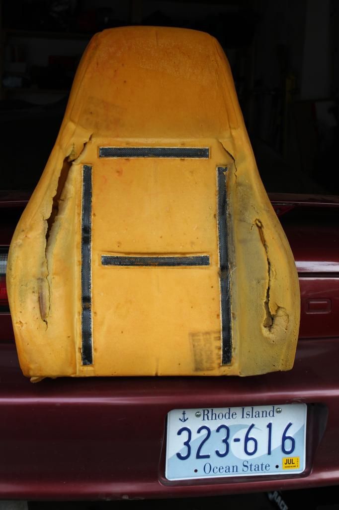

While waiting for the part decided to see if I could work some magic on the drivers side seat. GM seat foam from 1995 isnt holding up well!!
Now I know what those things poking me in the sides where, bolsters!!! Who knew!

Some ghetto seat repair using left over foam from work. Will see how it holds, zero dollars for the foam, and a few cents for the racing tape.

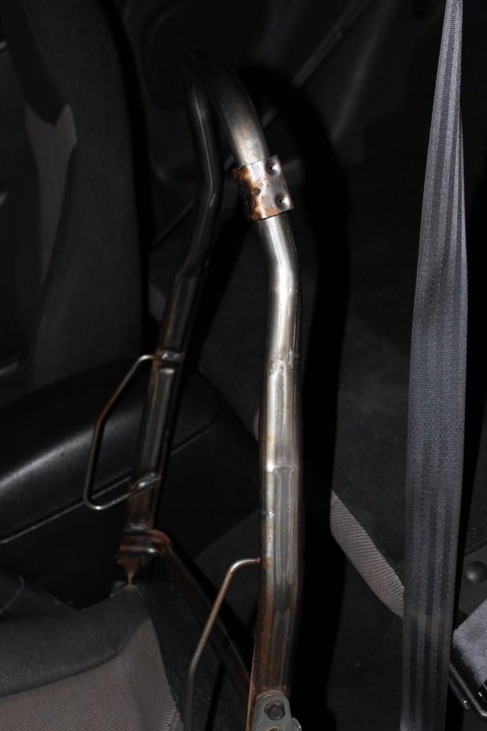

Homemade panhard installed. A quick dump of the misc fastener buckets netted some nut spacers.
Now have to figure out what to use as a reference to center the axle. I am surprised how easy the car body moves just turning the tubing.
