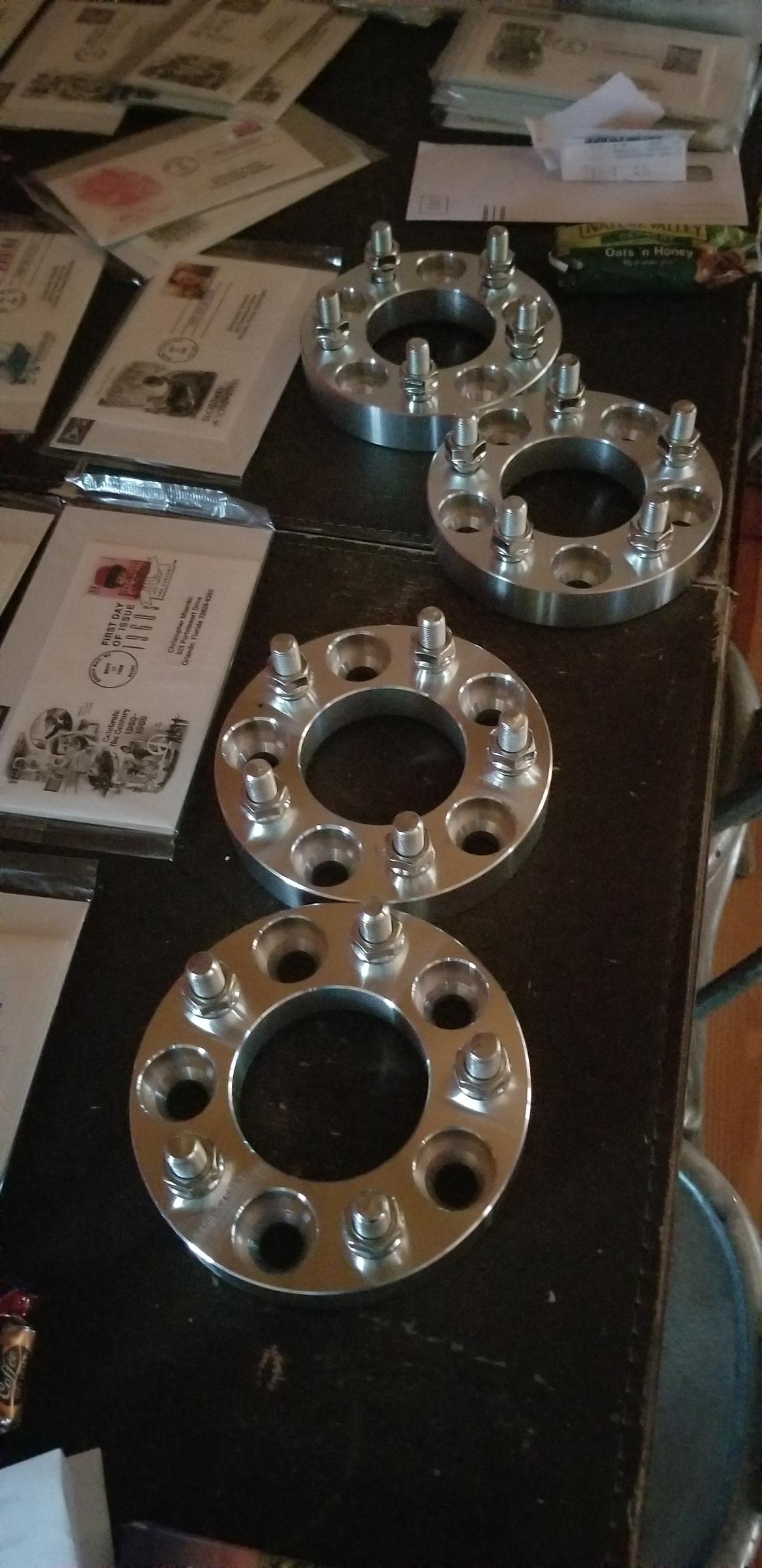

I couldnt beat 75 bucks thats for sure. especially to have a good set of mechanical gauges to help monitor my my motor which will be heavily abused lol.
