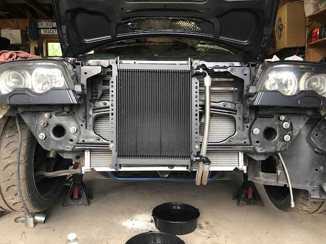

We've been dealing with some heat soak issues also, previously we'd do 2 laps, cool down, 1 more hot lap then the session would be over. For this year we're really targeting doing 3 hot laps back to back to back in preparation for the 2019 One Lap of America where you have to do that twice a day for a week. Water temps have never been an issue since installing the CSF radiator, however the C&R oil cooler didn't seem to be able to keep up with the heat. So, enter this massive piece from Setrab, oil capacity is now up by a full 2 quarts, and it's rated for 50% more hp than I'm making!

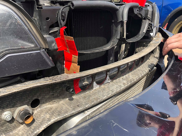

We learned as it turns, out, all that extra blockage in front of the radiator means that now the radiator isn't getting the airflow it was before which caused coolant temps to go up.  After 2 laps water and oil temps were high enough to worry us into back down, sometimes even midway through the 2nd lap. Great, money spent and we made the car worse.
Since we were at Gridlife when we learned this interesting bit of information there wasn't a ton of options or time between sessions, Thankfully Gingerman is only an hour from my house so my brother in law brought out some power tools and a beat up spare bumper from a car we parted out:
This seemed to help a bit, oil temps were still just as bad as they were previously with the C&R cooler BUT, we could now do a 3rd lap at speed without getting into the "DANGER WILL ROBINSON" area.
A bit of temp data from the AIM, all sessions shown were within 5-10 degrees ambient, so not a massive swing.
2 laps in green are from last fall with the C&R oil cooler in factory location and CSF radiator
2 laps in blue are from this summer with the new cooler in place
2 laps in red are after we cut up the bumper
So, we've got temps back down to where they used to be with the old setup, ie. no improvement. Not captured in this data is that oil temps would continue climbing steadily for the green laps if we started a 3rd one, meanwhile the red laps sort of plateau and hold. so we did get a bit of improvement in length of time we can push the car.

is that a carbon fiber bumper beam?  if so, that goes down as a TIL (today i learned)

Yep! kevlar crash beams were factory on the M3's front/rear compared to the aluminum ones on all other 3 series.
