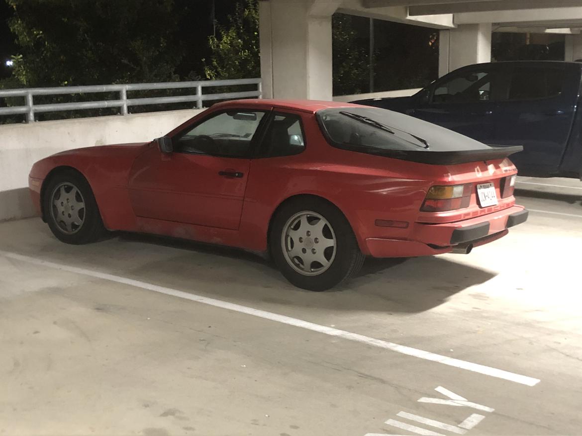

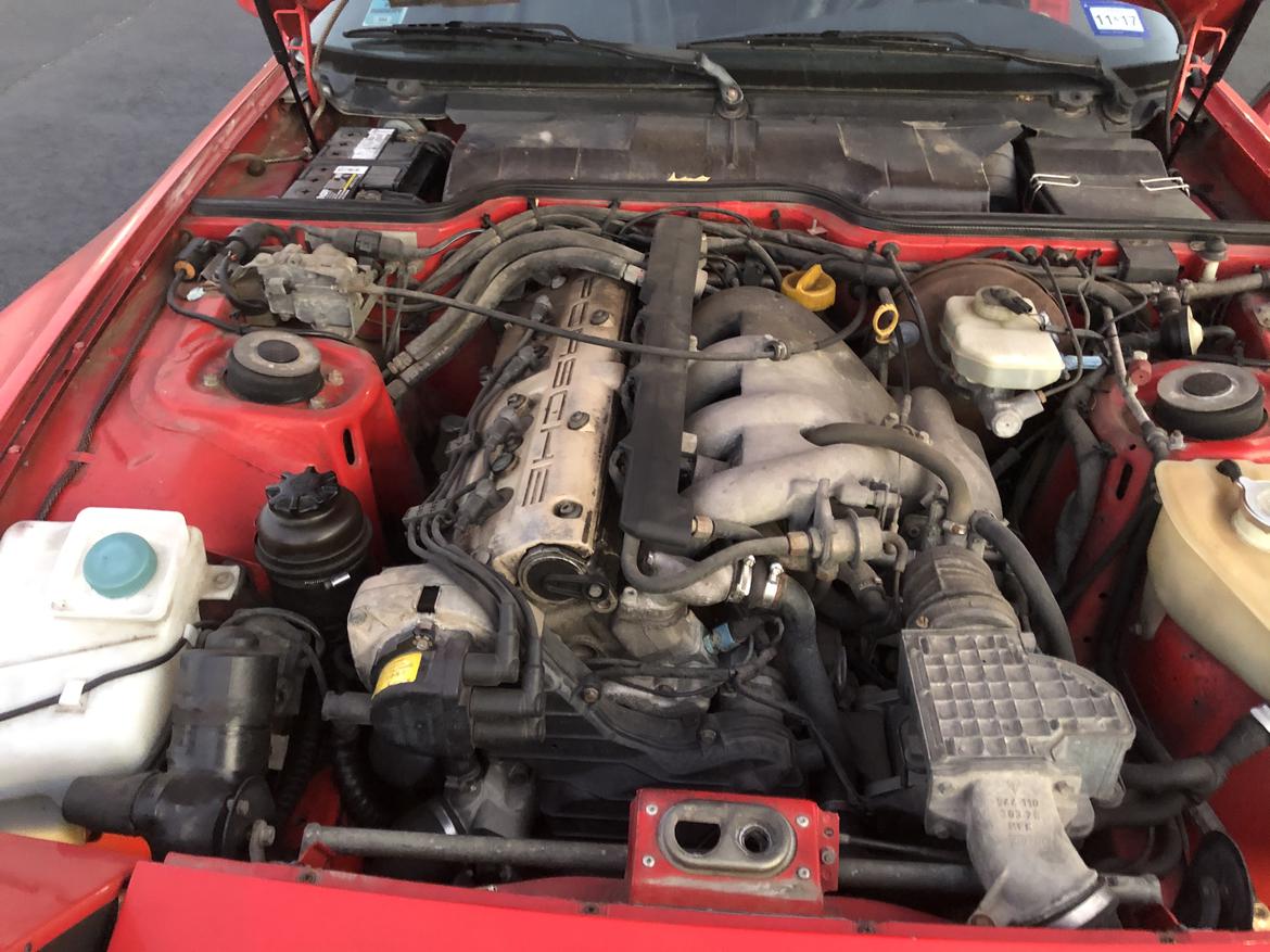

Can you ever have enough Porsches?  I went and looked at this today and I'm 90% sure I'm going to acquire it.  It needs body work and paint, but I have a guy for that.  Mechanically it seems pretty good needing new shocks and probably lots of rubber.  The 16V 3.0 L drives way better than any 2.5L 8V 944 I've ever driven.

S2 is a 3 liter 16v motor.  If you don't have a receipt showing the belts being replaced in the last 30k miles and 4 years do them immediately!
Also it'd be nice if the clutch has been done along with the oil pan gasket.

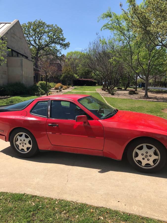

I've read all the 924 / 944 build threads I've found on GRM, and I really want to get this car.  Part of me is dreading the cost of the body work and repaint, but the S2 is rare....  only 1929 S2 coupes were brought into the US over 3 years.  The US got 14235 turbos and how often do you see those?  The least expensive restrored S2 I've seen is at 18k, so the car is probably worth rescuing.  The interior is very nice with reupholstered seats.
There is vibration from idle to 2,000 rpm making me think thr motor mounts are gone, but 4s vibrate.... naturally.  And its a big 4.  The car drives effortlessly compared to the single cam 2.5s which have to be beat on to go.

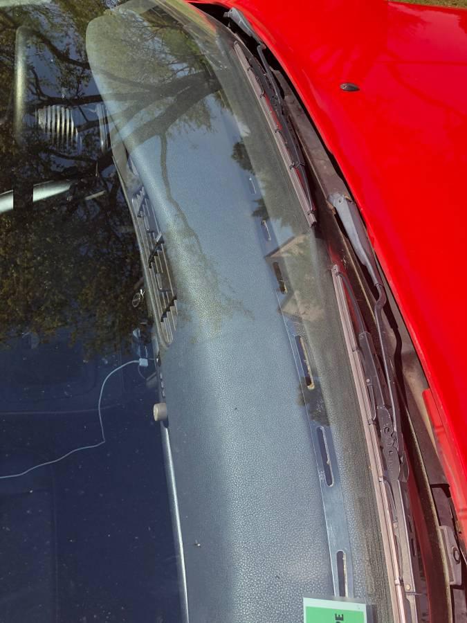

It's a lot rougher than the 10 fter photos suggest.  It's also a mix of factory single stage  (body) and aftermarket two stage (roof) now peeling paint.

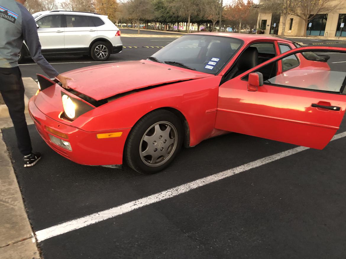

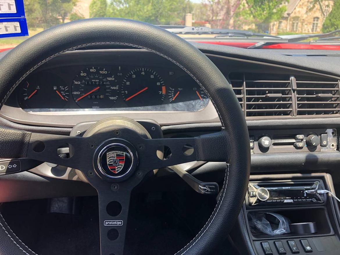

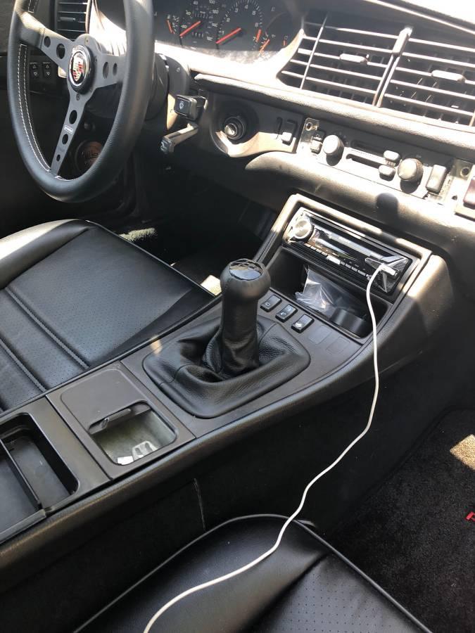

She ain't much but she's all mine.  I wish the PO would've left the steering wheel in it....  I have the factory one.
Now the decision:
To decide:  1). restore?  2).  Mild mod into autoX, HPDE, nice driver?  3).  Track dedicated build but still street legal.  This car could go any direction.
We make the trip home tomorrow.  20 miles in heavy traffic today revealed more big gotchas.

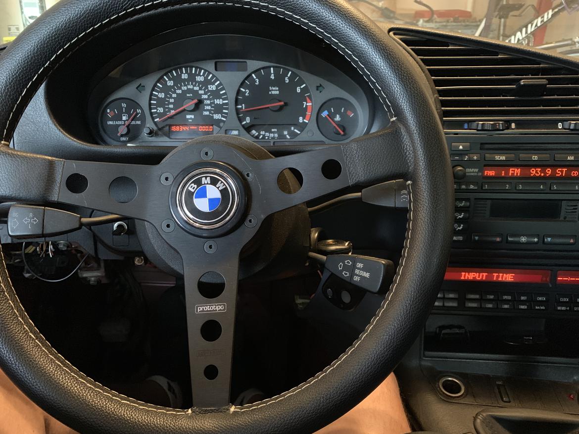

The steering wheel is not expensive if you want to swap it, I paid less than $200 for my Prototipo.

Looks like you have a good s2 starting point.  I’d be planning to bring the car back to stock specs and drive it.  In my experience if you build a track car out of it the value of the car will diminish especially a s2 being so rare.  Many don’t care about that and I’m kinda in the middle on it.  I have a 89 turbo so I know a little about the 944.  In addition to the recommendations above this would be my first step unless you have receipts proving replacements.  Replacement of your cam chain and cam chain tensioner pads. This is as I understand it the weak point of failure for the twin camshaft S, S2 & 968 engines. Best of luck.

Make sure you check the cam chain tensioner pads - if they go on the twin cam cars it will destroy the head, which are apparently made of Unobtanium (the price of rarity).  And echo the advice about the timing belt.  Nice find, you'll fall in love with the pull of the 3.0.

Have receipts for timing belt in 2013.  No receipt for timing tensioner pads or chain.  I need to do these and motor mounts this year.

I agree but I can still autoX it once a year or so.  The PO spent his money on the interior.  He redid the seats and dash.  It does need some attention, but nothing major.  The major item is paint which I can hire out later this year.

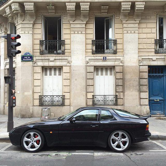

Teaser photo of wheels I just had to have.....
