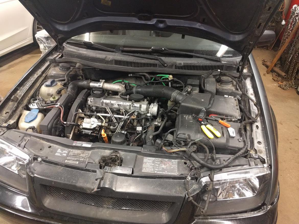

Drove the Golf down home to work on Mrs. Braps cousins TDI which has a miss fire.

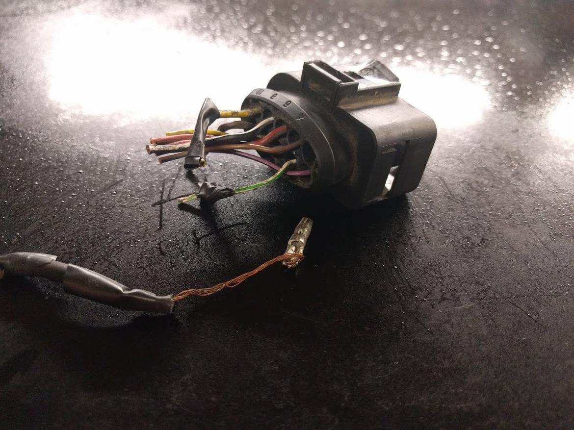

Opened the Hood to find some hacked up wiring and green vacuume line with splices in it..... Awesome this is going to be fun.
Here is the plug that the PO did the Evry mod to.....
After we swapped the plug for a good one it ran a ton better, but wouldnt build boost.....
A quck scan with the OBDEleven and checking over the lines... Found that the N75 Valve was not working.
Plan is bring one down next weekend and fixing it and seeing were we are standing.
