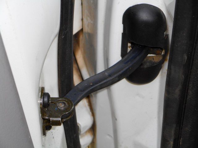

Well, if I can't fix all that right this second, what can I fix? First, here's that broken door check:
I scored the replacement from a truck missing a door, so it was already half unbolted. Junkyard shopping is easier when you let other people do the work for you. Cost: $6.58.

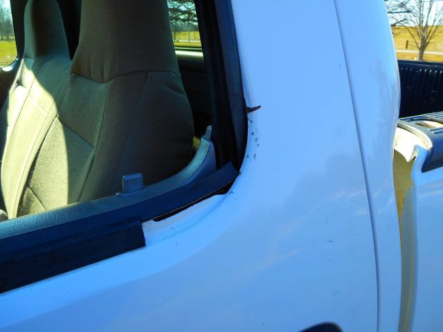

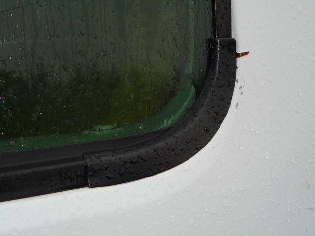

The rubber window/door trim on the driver’s side was broken, so I replaced that. $2.58.
Note the crack in the door (brown spot). Thought it was weird, but every F150 of this era I saw at the junkyard had the same problem. Turns out it's very common on this generation.

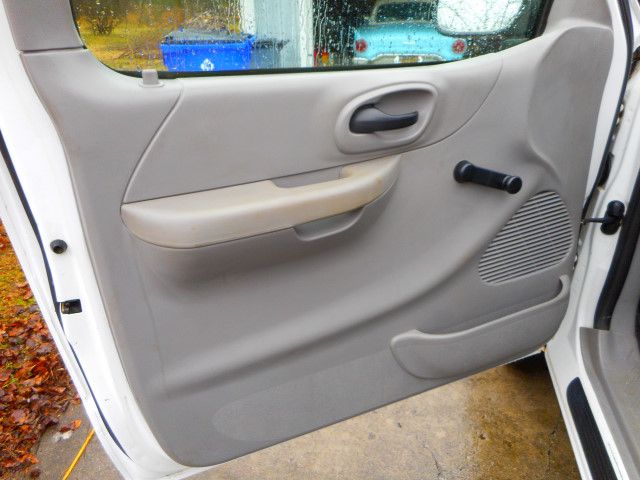

Again, this truck has no place to put stuff, so that's the main thing I want to address. For example: You don't really appreciate map pockets until you don't have them.
The first F150 I saw at the junkyard had gray, crank-window door panels w/map pockets. Didn't even have to remove them: They were sitting in the bed. Someone had even taken them out properly. $31.16 for the pair.

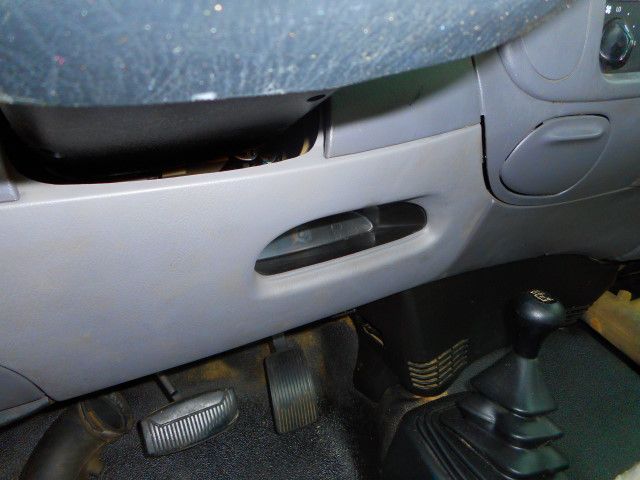

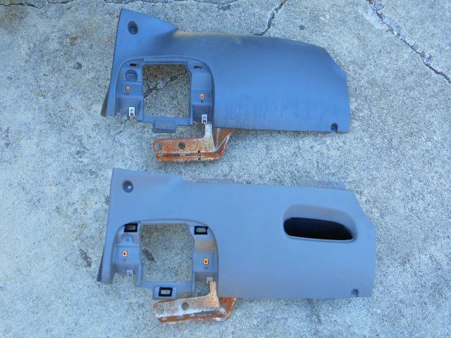

Some F-150s (not sure exactly which trim levels/years) came with a lower dash panel that has a storage cubby. Mine did not.
The color is a better match than the picture suggests. It may not hold much, but for $8.58, why not?

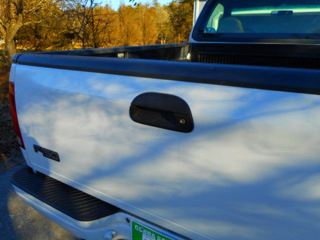

I don’t know if anyone would steal a tailgate so basic it doesn’t even have a lock (much less step, camera, etc.) but I do know I don’t want to find out. So I picked up a locking tailgate handle and took the core to a locksmith to have it keyed to my ignition key. Unfortunately, I thought I would only need the handle itself, but I had to go back for the rest of it that pulls on the rods going to the latch on each side, so that upped the cost. $21.16 for the parts, $35 for the re-keying.
See that black plastic thing at about 9 o' clock that sort of has three fingers and is closed off at the end? Non-locking tailgates don't have that part, and it's what actually prevents the handle from pulling on the rods.

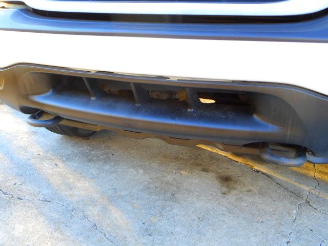

Also picked up a set of factory tow hooks. I see no reason not to have them. $15.16 for the pair.

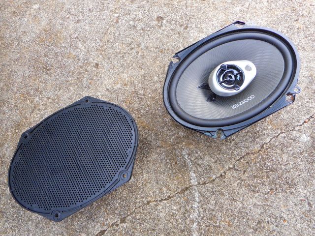

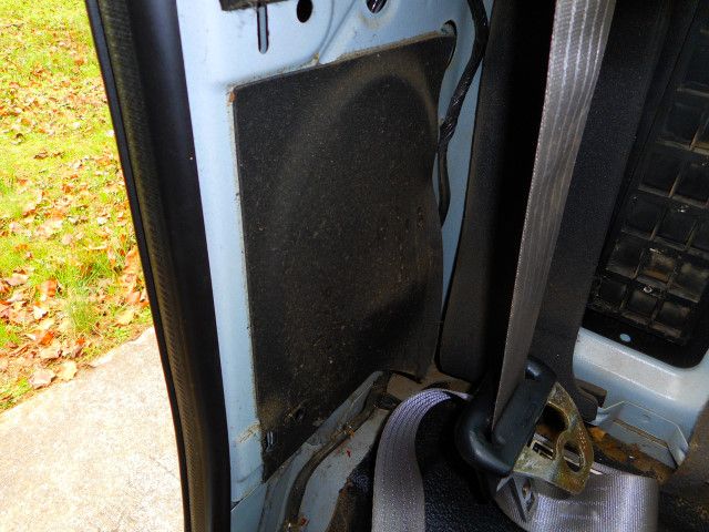

So I continue to work on other things, too. This truck came with door speakers only, but even the Work Series is wired for optional rear speakers. I added a pair of speakers to my junkyard list. I planned on just finding a pair of factory speakers, but as I was removing another part from an Expedition, a missing door speaker grille revealed a Kenwood logo. All speakers are the same price at the junkyard regardless of quality, so I grabbed not just two of them, but all four. At $5.58 each, why not?
Turns out they're Kenwood KFC-C6893PS speakers--an older, discontinued model, and nothing super fancy or expensive, but better than the factory speakers, I'm sure. Here's one next to the stock version:
They don't use the same connectors as the factory speakers, so I ordered some cheap adapters. Installing the fronts isn't really worth a picture. After removing the plastic trim from the rear of the cab, you'll see a big sticky piece of soft rubber covering the hole for the speaker:
Remove it and you'll see the connector plugged into a dummy plug to keep it from rattling around.
Hook up the adapter, plug it in, and four screws later, you're done.
