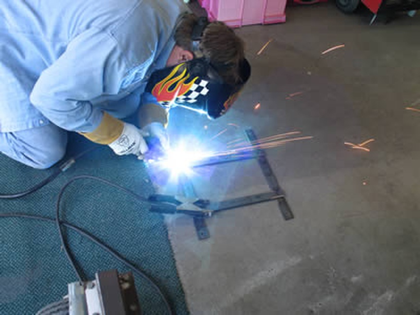

We installed our GTS Classics seat on Saturday. The seat came with a slider mechanism, but we needed to weld up a bracket to mount it in our car. We used 1/8-inch thick steel bar that measured one inch across. This material was measured and then cut to have two side-to-side straps and two fore-aft straps which were then welded together.
