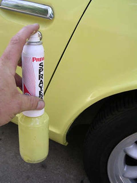

The previous owner of our Z touched up a few spots with a non-matching yellow paint. We sanded these small spots down and sprayed in a few sections with a disposable airbrush. The color matches very closely and with some wet sanding and buffing, it’ll be hard to see where we sprayed.
