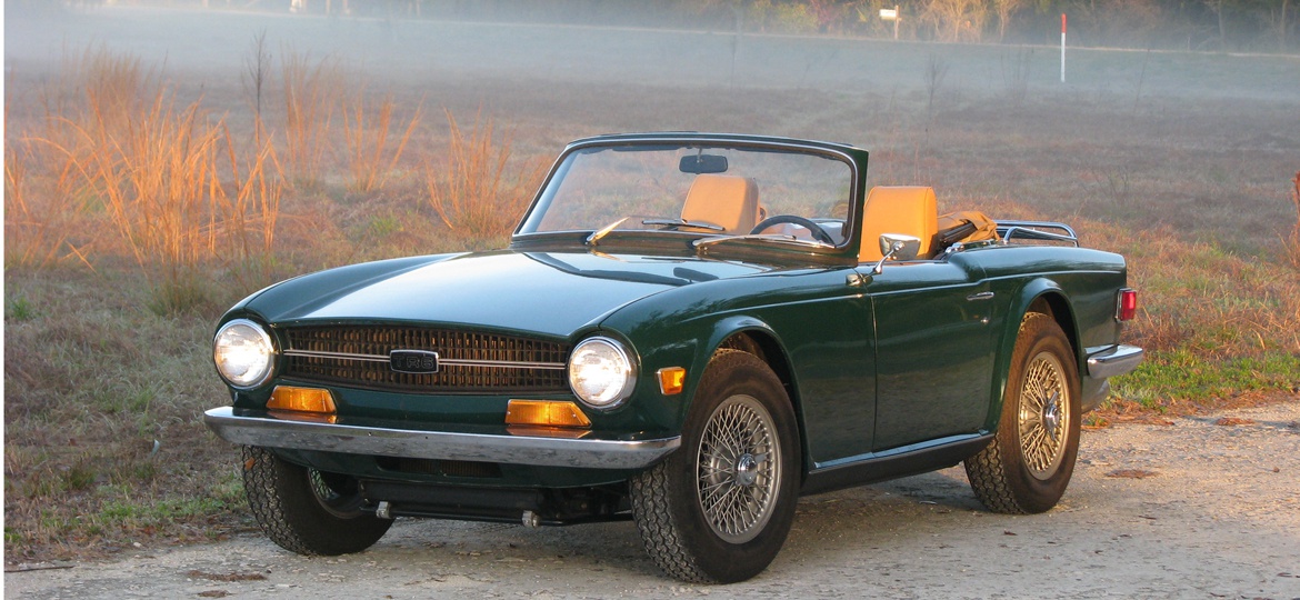

The Triumph TR6 has been a cornerstone of the sports car world since its 1969 debut: strong lines paired with an equally strong engine. These days, however, the newest example is …
