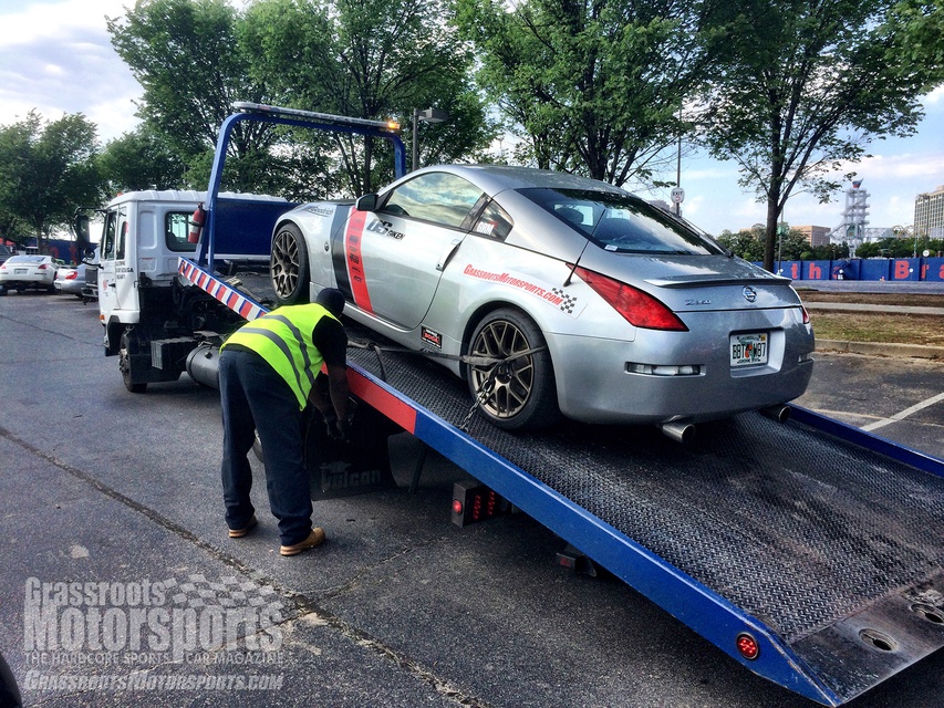

Once we pushed it off course, it was clear that the right side axle had worked its way out of the differential to the point where the splines were no longer engaged. While we considered just trying to work it back in and continue our day, we wouldn't know the full extent of the failure without disassembling the diff housing. And we didn't want to cause any further damage if we could avoid it.
So we called AAA and trucked the car up to our pals at Balanced Performance in nearby Sugar Hill, GA. Jason and the gang at Balanced diagnosed the problem Monday morning. Actually, it turned out to be a bit of a compound issue.
The OS Giken diff we had installed indicates that if you are switching from a Nissan VLSD to the OS Giken—which we were—you'd need to replace one of the output shafts with an output shaft from a car originally equipped with an open diff. Apparently though a translation error, we now know that those instructions are supposed to specify that you need to use both output shafts from an open diff car. As a result, one of our output shafts did not get a C-clip installed because the groove for the C-clip was not visible when the shaft was reinserted. The guy performing the install therefore didn't install the clip, and when the rear axle was subjected to side loads, the shaft eventually walked itself out. We got an ABS/Slip warning light at one point on the drive up to Atlanta, which we now realize was from the indicator ring on the output shaft being misaligned. At the time we chalked it up to decade-old electronics and a car that has seen at least five CARFAX-verified collisions.
