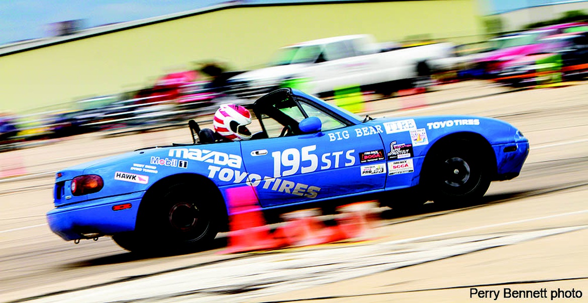

VENUE: The most competitive place to race a truly low-dollar, 1.6-liter Miata is the SCCA’s Street Touring S autocross class. At last fall’s Tire Rack SCCA Solo National Championships, 63 drivers entered that STS class. A Honda CRX driver took top honors, but Andrew Canak drove a 1991 Miata to second place.
TIRES: The high-performance market for 14-inch tires has dried up, but fortunately the Miata easily accepts 15-inch wheels–and they’re legal for the Street Touring class.
If you can’t find something good on the used market, places like Goodwin Racing, Discount Tire, Tire Rack and König offer a great selection of lightweight, inexpensive wheels–some priced near the $100 mark. A 15x7-inch wheel is good, but a 15x7.5-inch wheel takes full advantage of the rules.
The top cars at this fall’s Solo Nationals ran on Bridgestone Potenza RE-71R tires, and Tire Rack charges about $120 each for the popular 205/50R15 size. The BFGoodrich g-Force Rival S, the other contender at Nationals, sells for just a few dollars more. According to Tire Rack’s Chris Harvey, there’s no need to shave either one.
The Toyo Proxes R1R, now available with a 200 treadwear rating, retails for a little less than $120 each in a 195/50R15–the hot size for Miatas in that particular tire. The Toyo was popular in the past, but a rule change legislated it out of the class. The new treadwear rating has now returned it to the street tire fold.
Have less cash to spend? It may not have a win at the Solo Nationals, but the new Kumho Ecsta V720 retails for about $100 apiece.
DIFFERENTIAL: To help those tires grip the road, you’ll want the optional viscous limited-slip differential. If your car doesn’t have one, Treasure Coast Miata can hook you up for about $300. (A more effective Torsen differential became available starting with the 1994 model year, but it’s not legal for the STS class. Treasure Coast Miata sells a Torsen conversion for about $850, and it includes the complete differential plus the axles and driveshaft needed to complete the swap.)
SHOCKS: For autocross–or really any performance driving–you’re also going to want good shock absorbers. Goodwin Racing offers the popular Koni dampers for less than $150 each.
SPRINGS: Stiffer springs that lower ride height are also part of the equation. Off-the-shelf lowering springs start around $200. Adjustable coil-over kits allow more suspension tuning, but that comes at cost. Ground Control’s popular Miata coilover kit retails for about $1250, and that includes the Koni dampers.
ANTI-ROLL BAR: We’d also go bigger on the front anti-roll bar. Racing Beat’s popular hollow front bar usually retails for a tick above $150. It’s available directly from its maker as well as retail outlets like Good-Win Racing and Moss Motors. Just about everyone else in the Miata market offers suspension upgrades, too, including Flyin’ Miata, Moss Motors and Mazdaspeed Motorsports Development, the marque’s own competition arm.
POWER MODS: If you have any budget left, then start looking at things that add power. Cold-air intakes, free-flowing exhausts and ECU upgrades are popular and legal in the STS class, and the usual suspects can help.
