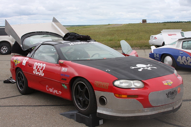

    Back to the camaro now. The camaro is deemed a 'bottom breather' from what I have been reading online, simply meaning it takes its radiator cooling air from under the bumper instead of through it. I want to block off any obstructions in the bumper to see if that helps my mpg, but I don't think running an air dam across the front edge of the bumper will bode well for summer driving. Sitting in traffic I see the temp gauge creep up to 210 in normal driving. Apparently that is normal operating temp for an LS1 but the first time I noticed I was freaking out thinking the car was going to overheat.
    Would running an air dam from the radiator back be just as effective? I am thinking about grabbing some cheap garden edging and adding it to the stock air dam that hangs from the lower core/rad support and possibly down the pinch welds on the side of the car. Its a black car and sits low so it shouldn't be too noticeable.
    Stock:
    Highly Modified:

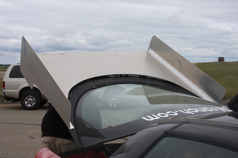

    Sweet spoiler, but I don't think I'll be that hardcore
    Middle Ground: (Grill Blocked, Fog lights blocked or mounted flush)
    (Extened Air Dam)
    (Rocker Dams?)
