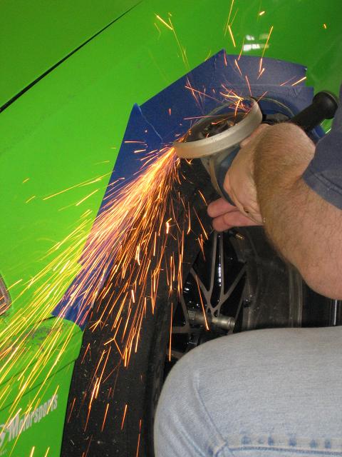

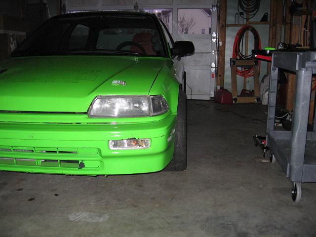

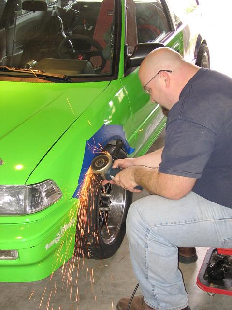

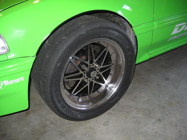

    Unfortunately, big tires and Civics were never mean to co-exist. That's why today's project was fender trimming. I took it for a spin with it's big tires (275/35/15), figured out what was hitting, and then went to town. I can actually get full lock, though with less than 1/4" of clearance on the inside. That may turn into rub once I've got the tires mounted on the right rims (15 x 10 instead of 15 x 8). We'll see. The place it was hitting was the top of the fender well. Makes sense, as the tire sticks past the fender and there was ~1" of room between tire and fender at the top. What I did was take the 2" space that existed front and rear, and cut the top out to match, such that the tire now has 2" of clearance all the way around. A test drive involving heavy turning, heavy braking, and even a bit of curbing where appropriate reveals no more rubbing. Woohoo.
    I will admit that taking a ziz wheel to the car is still pretty stressful, but I'm learning to embrace it.

    I must say, those wheels are awesome.

    I like them too, but they are going to be relegated to rear-only before long. I'm converting the front to a wide-5 setup (yes, like circle track cars) so that I can run affordable yet light weight 15 x 10's.
    At some point, the rear may also go to wide-5, as the appeal of magnesium hubs may be more than I can resist.

    Nice job and looks good but no gloves or safety glasses? Shame on you Dave, I thought you knew better!
  • DILYSI Dave
    Feb. 15, 2009 7:14 p.m. DILYSI Dave UltimaDork
    1. I am wearing safety glasses.
    2. Using gloves with power tools are a good way to turn what would be a flesh wound into broken or missing fingers. Bad idea.
