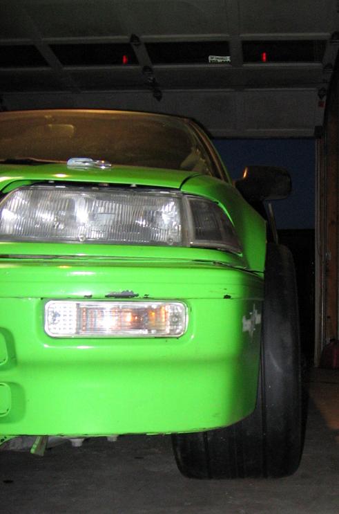

  • thatsnowinnebago
    March 8, 2009 12:22 a.m. thatsnowinnebago HalfDork
    that last picture is ridiculous, you've got some huge tires on that car
    "good ridiculous,". of course
    It's gonna be trippy being able to just hammer down through the corners like that. It's just going to stick no matter what you do.
    but of course
