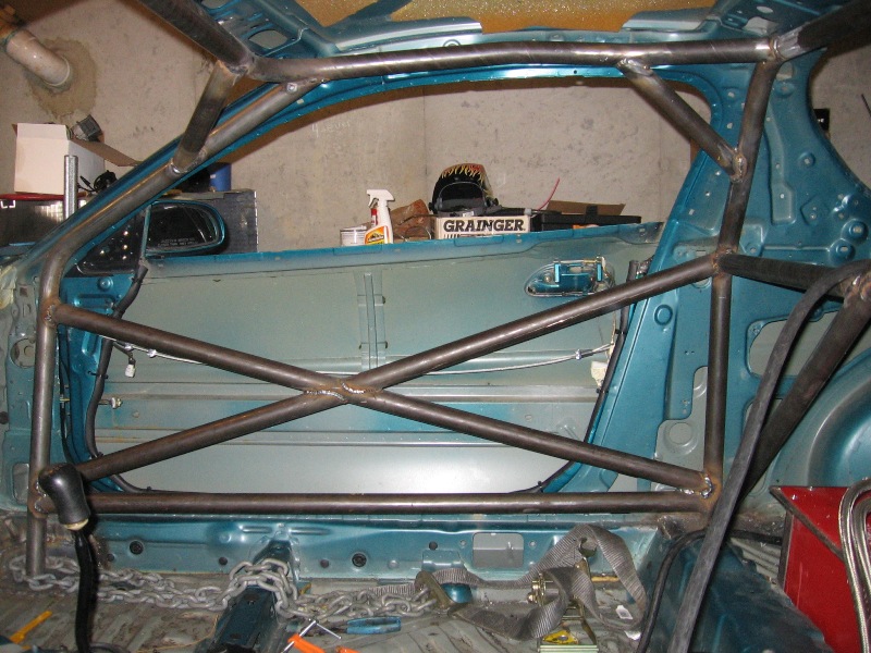

    Also - If headroom/entry/exit is a concern, consider putting a kink int he halo bar. Here's a cage I built -
    That little 5* kink made a huge difference in headroom.

    I don't like that at all. While i always wanted to have them built on the big side to keep the bars away from the driver, You should never be the outer most part of the car, in a rollover if you stike an object upside down you will hit before the cage which pretty much defeats it's purpose. In a closed car I like Dave's idea, and in an open car make it taller then the windshield if that makes you comfrotable.

    On an open car, SCCA rules for a 'race ready' cage say that if there is not a front cage hoop, then the rear bar must be tall enough so that if you drew a straight line between the top of the rear hoop to the front of the car (think of it as laying a straight edge from the hoop mto the part of the car that would be on the ground if it were upside down) that line must be at least 2" higher (IIRC) than the driver's helmeted head. That's why the Abomination's 4 point roll bar is so high. About adding headroom: when we built our last LeMons car there's two of us who are rather lengthy and the previous car's cage did interfere with the melons. So we built this halo with extra height in mind. The bends at the rear of the halo allowed us to tuck it up inside the car's roof and greatly increased the headroom, notice in the side picture it's nearly invisible from the outside even though it's 1 3/4 .095 wall DOM tubing. The halo also ties in directly at the point where the rear stays come in (remember the load path thing). The cage passed LeMons tech (and should pass SCCA), but the more Toyman and I have looked at it the more we keep saying we should triangulate it at the rear, from the halo down to the main hoop. We will probably triangulate or gusset it at the front as well.
