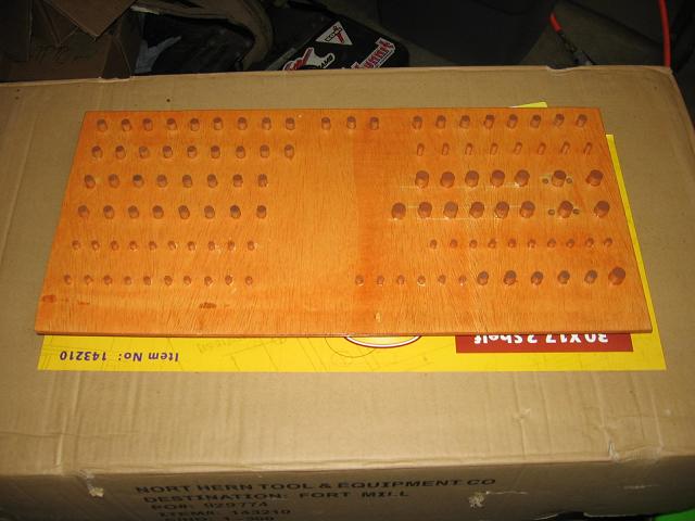

    Since the Civic is "finished" I've been cleaning the basement. Part of that is better tool organization / populating the bigger tool box. I've had a pretty good socket set for the past 15 years or so, but it came in one of those blow molded plastic cases and it gave up the ghost long ago. I hate all of the drawer organizers I've seen, so I decided to make my own.
    Ingredients:
    2' x 2' sheet of 1/4" plywood. I got a nice piece of cabinet grade stuff for $7.
    1/4" x 36" dowel
    3/8" x 36" dowel
    1/2" x 36" dowel
    Varnish
    A few hours organizing, drilling, gluing, and staining later and we have this -
    I like it better than store bought options and have maybe $20 in it.

    I've tried the rails. Don't like them. They are a lot more transportable than this, though this box pretty much lives in the workshop. I've got a traveling box with a separate small set that goes to events, junkyards, etc.

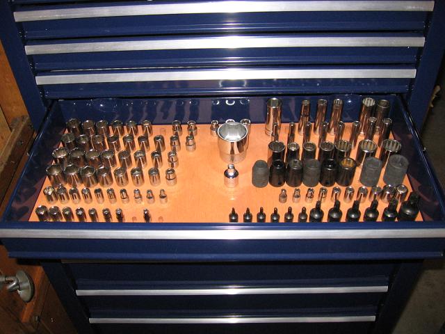

    July 6, 2009 5:57 p.m. Grtechguy UltraDork
    I have to bump this..... presenting my newly organized drawer.
    Gotta love having a retired dad looking for woodworking projects
