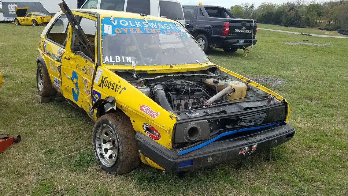

We first worked with Chris Albin on magazine stories some 20 years ago. His car has even graced our cover. When we saw this weekend’s video of his familiar, yellow VW Golf crashing into the trees, our heart skipped a beat. Fortunately, he emerged okay.

So, reading between the lines because it's never actually stated - it was a brake line failure?

Keith Tanner wrote: So, reading between the lines because it's never actually stated - it was a brake line failure?
Yep. There's a photo in the main story.

Ah, found it. Failed at the crimp.
So the followup article is to get that brake line to a specialist and figure out why it failed. Obviously it's not a new line. Are they a consumable? Why did he have two failures in short order? What can we collectively learn from this?
We sell SS brake lines. which means I get to hear about any problems over a reasonably large install base. The failure rate is extremely low and nonexistent as a catastrophic failure.

As hydraulic hoses are a big part of what I do to make a living, I can add some insight, it might even be worth more than .02¢. (but not more than .04¢)
Since it failed at the crimp, and in fact, looks like it pulled out of the fitting completely, it was a manufacturing defect.
The hose may not have been fully inserted into the fitting before crimping, or the crimp was not tight enough. That could happen for a few reasons. The few times that I've had braided stainless hoses made, the very top of the hose that goes down inside the fitting were wrapped with tape like packing tape to keep the braid together. If there is too much tape, the tape is sloppy or the braid for some reason starts coming apart, it will be very difficult to 100% correct crimp. It will probably be loose, but look good. Certain types of crimping dies will more likely to have this problem than others.
When they break in the fitting, or just past it, the crimp is usually to tight or not centered in the die.

So, would there have been any way to determine from a visual inspection that there was an issue with that line?

I see in 1st post it suggests that the failed line was the one that was replaced the day prior. What are the odds that it really was the other side that failed and not the replaced line? I know I've learned the hard way when it comes to brake components to replace in pairs or all. If one side failed, the other side is soon after. After all, the have pretty close to the same wear. Sometimes the other side fails because it becomes the weak link after putting a new component on the other side. Learned that with brake cylinders, one fails replace both because the other will fail soon after.
