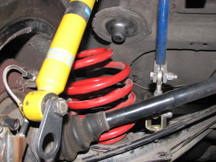

Our season debut with the Spec E30 is less than a week away, so we needed to address our weight issue. Specifically, our car is very light, and we needed to add some ballast to ensure that we'd still be over the class minimum of 2750 pounds with driver after we've burned up some fuel. When we weighed the car with a full gas tank, we only had 4 pounds of leeway; that's less than a gallon of gas.
We were also a bit discouraged by the rear corner weights of our car; the left rear was 100 pounds heavier than the right rear. Fellow Spec E30 racer Rob Keehner saw our forum thread at spece30.com and suggested we play with the spring pads to get a slightly more favorable distribution.
To review, before touching the pads, we had corner weights (in pounds) of:
LF 729 - RF 743
LR 691 - RR 591
We pulled the top and bottom spring pads from the left rear spring perches and weighed the car again. Sure enough, we saw an improvement:
LF 753 - RF 718
LR 668 - RR 615
