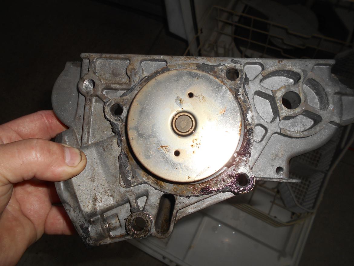

Here's a picture of the old water pump. I can see no obvious holes for sleeves/dowels/etc.
Still, I don't like how it felt, so I'm going to pull it apart and try again.
I find no part numbers other than the one we agreed was for the belt tensioning spring, so It may just be down to manufacturing tolerances. Or paranoia.
