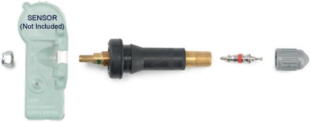

dj06482
dj06482 GRM+ Memberand HalfDork
9/11/12 8:04 a.m.
GameboyRMH wrote: The sensor itself can't cause a leak, it just hangs on to the inside of the valve.
You're correct, but the challenge is that the valve stem and TPMS are integrated into one part. So, if the valve fails, the whole thing needs to be replaced. I'd be much more interested in a set where you can replace only the valve stems with tire replacements, as the TPMS sensor itself should last longer than the valve stem (and is far more costly than just the valve stem).

dj06482
9/11/12 9:01 a.m.
GameboyRMH wrote: Aren't the sensors held onto the bottom of the TPMS-compatible valve with a tiny nut? Or at least you can definitely buy that type...
I haven't seen the sensor first-hand, but there are several decent pictures floating around on the web:
GameboyRMH
GameboyRMH GRM+ Memberand PowerDork
9/11/12 9:06 a.m.
Sure there's not a nut or screw in that slot facing away from the end of the valve?

corytate
corytate Dork
9/11/12 11:58 a.m.
GameboyRMH wrote: Sure there's not a nut or screw in that slot facing away from the end of the valve?
some chevys are like that, I havent seen any others like that though.
Some fords have a band around the wheel, sensor is 180* opposite valve stem. MOST have the metal valve stems though, all one piece with a nut holding the vs/sensor to the wheel
All nissans, all korean cars, all subies and toyotas I've worked on have had the metal kind.
