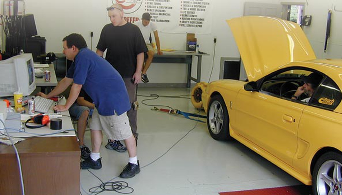

One of the boons to performance enthusiasts in the last decade has been the development of quality chassis dynos--ones that don't carry six-digit prices. Finally the grassroots gearhead can operate just like the pro teams, as more shops have been purchasing and installing these dynos and offering us average folks a chance to test and tune like the big teams.
If you've never had your car on one of these machines, you're really missing out. If you're prepared, you'd be amazed at what you can do and learn in 30 to 60 minutes. If you're not prepared, however, you may have a mess on your hands--along with a huge bill for wasting the dyno shop's time.
A dyno isn't some sort of magical device; on the contrary, it's actually quite easy to use and understand. Having a good game plan and properly using the data can often be the difference between success and failure.
