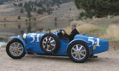

    Make it look like this:
    I'll have to forward that to Larry, and tell him he made the GRM Board.
  • fast_eddie_72
    Aug. 19, 2010 9:35 p.m. fast_eddie_72 New Reader
    Tell Larry I said he's cool as hell and that car is amazing.

  • Aug. 20, 2010 1:44 p.m. larrycrane
    In reply to fast_eddie_72: LOL!! Thanks Eddie. The car was brilliant, cornered hard, stable steering, good acceleration for a 2.3-liter DOHC, even if supercharged, engine. Hard to imagine it in 1931. Too bad there wasn't an 8C 2300 Alfa to compare.
