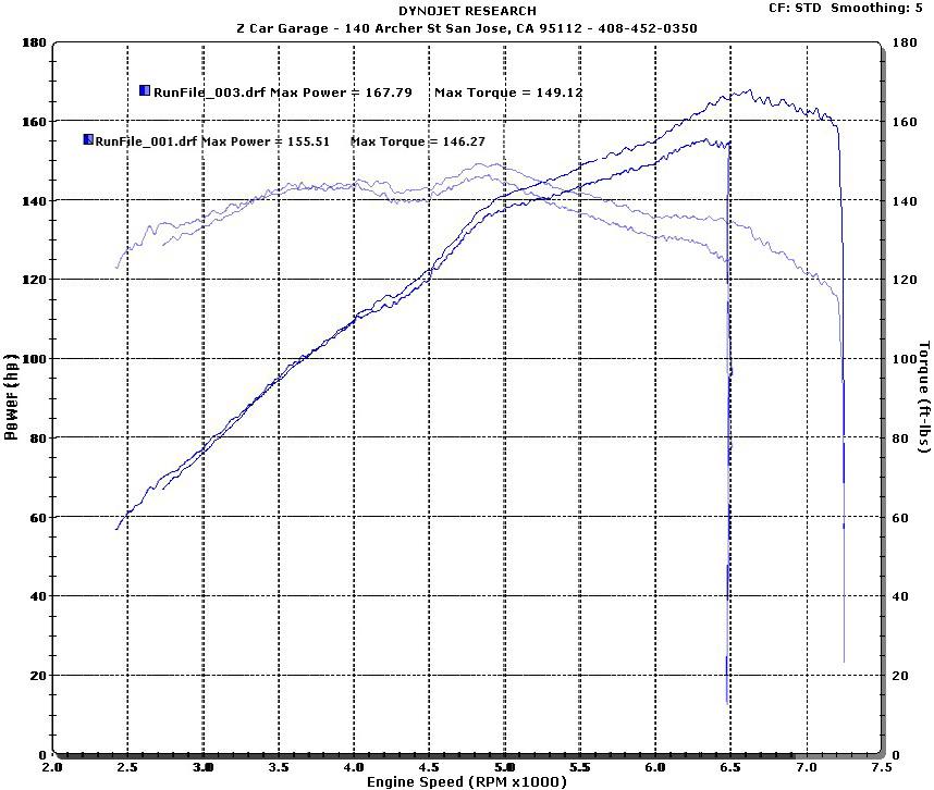

Rob also has a Dynojet chassis dynamometer.
We can’t yet share any driving impressions of the new MX-5 due to a media embargo, but we did gather some more facts and figures.
The first pull was made using sixth gear. The other two were made in fifth. Fifth gear delivered the best numbers: 168 horsepower at the wheels along with 149 lb.-ft. of torque. (And, yes, we rounded to the nearest number.)
Mazda's official numbers are 181 horsepower and 151 lb.-ft. of torque, which works out to about a 7% decrease in horsepower due to driveline loss. Calculating actual driveline loss is a notoriously inaccurate science, but for a rear-wheel-drive car, we're tempted to say that Mazda's rated power output might even be pessimistic.

PeteD
PeteD New Reader
8/4/18 5:15 p.m.
Why did you make the dyno runs in both 5th and 6th gear?
Wouldn't the 6th-gear results be most accurate because of the 1:1 transmission ratio?

Vigo
Vigo UltimaDork
8/5/18 12:45 p.m.
Technically as long as the dyno is directly measuring the engine speed (it always knows the drum speed) it is always going to calculate the gear ratio and you're still going to come up with basically the same power result. You can choose a gear either because you think it incurs the least 'loss' or because the gear isn't going to result in tire speeds on the roller where a tire failure would kill everyone close to the car. lol

Generally speaking, the 1:1 gear will have the least drivetrain loss because it's usually just directly coupling in the input and output shafts in the transmission, with no gears involved in changing speeds.  It's also usually the strongest gear, for the same reason.

In reply to codrus :
Hearty "it depends".  If it is an inertial dyno, testing in top gear may make the pull take so long that the engine heat soaks and loses power.  This is not as much a problem when you have a 100mph headwind.
I always tested my RX-7 in 3rd gear for this reason.

The critical speed of the driveshaft in my Caprice is about halfway through 4th, which is my 1:1 gear. As a result, I have to run in 3rd to keep the driveline speed down.

Rob, the dyno operator, was concerned about running into a speed limiter.

That just means you're not making enough power. :)
But yeah, it's worth doing a couple test runs to validate the testing methodology because it's going to vary by car.
