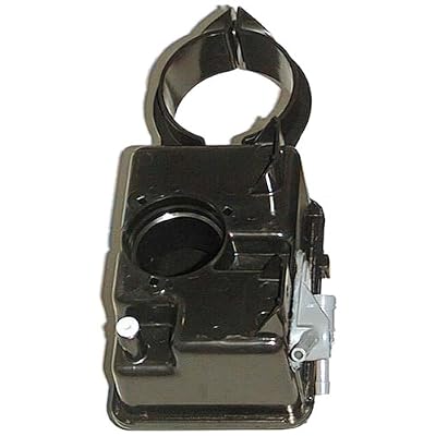

  • 16vCorey
    April 20, 2011 11:23 a.m. 16vCorey SuperDork
    jimbbski wrote:
    As for the number of fuel pumps: A low pressure pump to feed the high pressure pump is the way to go. VW uses that method on the Mk I & Mk II cars. The low pressure inside the fuel cell or below it if external.
    That's what we're running. The MK II VWs have the added bonus of having the external high pressure pump mounted in a small surge tank, so that's the one we're using. It looks like this:
  • donalson
    April 20, 2011 11:27 a.m. donalson SuperDork
    I know in the volvo they also used a dual pump system... but I think that was more of a practicality thing due to fuel pump technology at the time... the stock in tank pump is a high volume low pressure and the inline pump is a high pressure pump... but flows about 1/2 the volume (at least on the volvo)
    I think they did that largely because of finding a pump back in the 70's/early 80's that flowed enough and had enough working pressure was a problem...
    then again I suppose the fuel filter/fuel line does act as a very small surge tank...
  • donalson
    April 20, 2011 11:28 a.m. donalson SuperDork
    16vCorey wrote:
    very kewl on the mini surge tank... thanks for the tip :)
