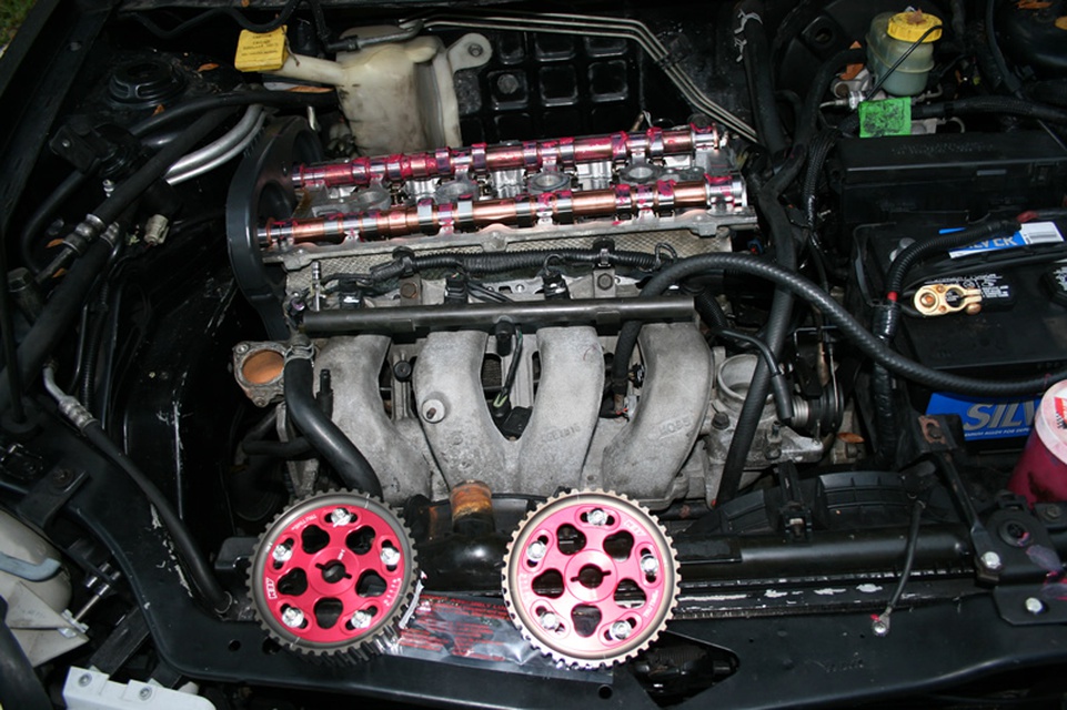

We took some time over the holiday to reassemble our Neon ACR's engine with a good, used cylinder head. While we were putting things back together, we also installed some Crane No. 12 camshafts and a pair of AEM cam gears.
We had to have this used head milled slightly, which threw of the cam timing a little bit. The …
