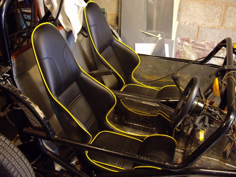

Besides those 914 seats, you might want to look into custom seats by Intratrim ( http://www.intatrim.co.uk ). Very popular with the Caterham/Westfield crowd in the UK. Several designs, including high-back options. Many designs are offered in wide and narrow widths. You can spec harness slots or plain. Also, some of the low-back options can have headrests added. Basic prices are quite affordable: like 350-500 GBP for a PAIR of seats. If you start adding options (leather, multiple colors, quilted stitching, contrast piping, seat heaters, etc.) then prices start to rise.
As an example, here's a pair of "slim fit" Odyssey seats in a Super 7 build:

Thanks all. The intatrim seats are really interesting - any idea how much of a hassle they are to import?
