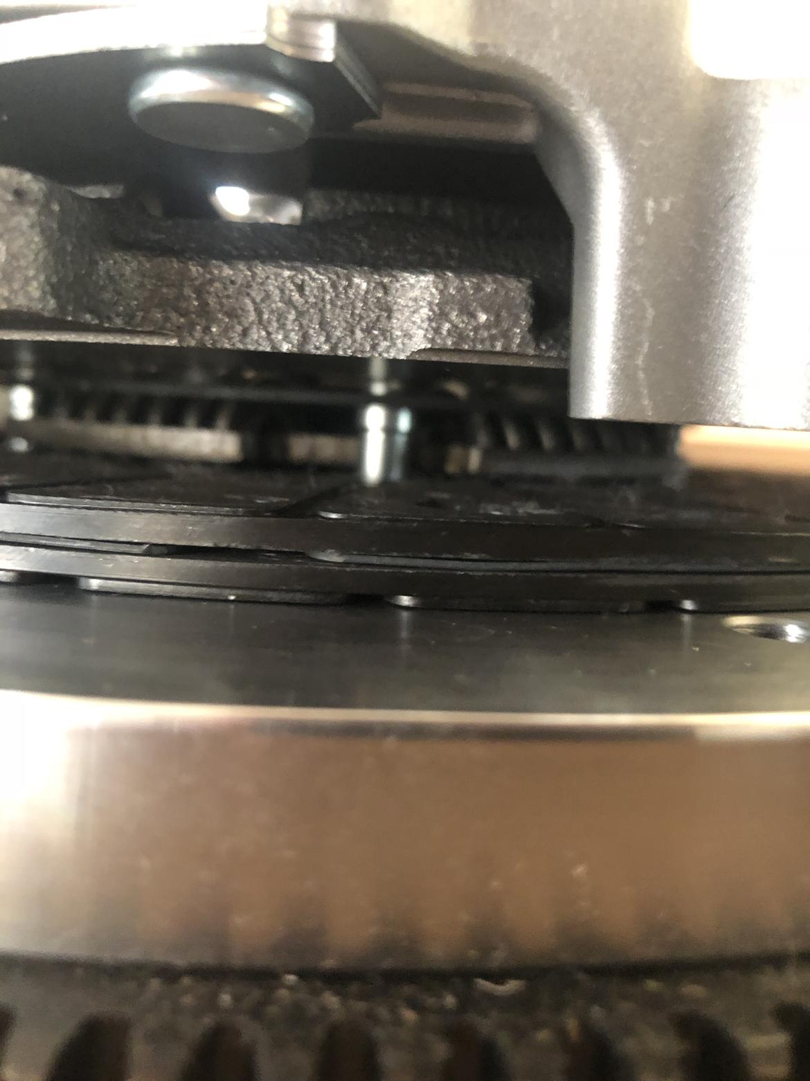

Hey everyone had a question I’ve been looking for a flywheel for my sbc  with a 1 piece RMS to bolt up with a T56 from a LT1. I got this Chevy 350 from blueprint and it says this for the balance kinda confusing “Internal Front/ External Rear” I got a MCL 460260 flywheel with a stock clutch for a T56 # is SUM-700830 and they don’t fit. Called summit and they told me it has to fit . I’ve also tried flipping the clutch the other way but the hole in the middle of the flywheel it too small which prevents the clutch to sit right
