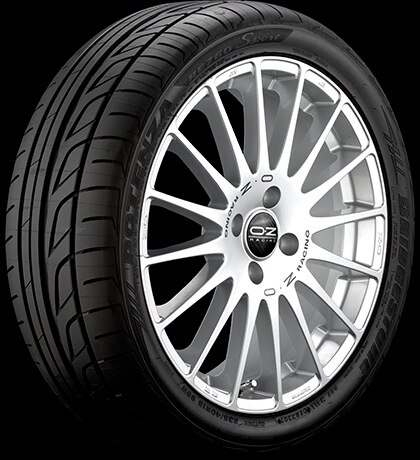

Looking at the Tire Rack, there is a Bridgestone Potenza RE760 Sport. It's pretty reasonable at $88.10 per, and seems to have good reviews. In fact, looking at my Tire Rack purchase history, four will cost about the same as two Eagle GTs for the front of my G35.

I have the RE760s on my 280whp WRX and have been extremely happy with them. Ride, traction, noise, steering response - all are excellent in the first 10k miles that I've put on them so far, and I drive this car HARD on bad roads. Rain performance is great as well. To be honest they feel just as grippy as the AD08s, Azeniz, and Star Spec 1's I've run on this an other cars in the past. The treadwear rating is good too and I don't see any appreciable wear on them so far, so hoping to get a lot more miles than my previous two sets of summer Dunlops.
Note that I have not (and will not) use them in snow/ice/sub-freezing temps since I have performance winters on another set of wheels for that.....so I can't comment on their performance in that stuff, though I suspect it's not very good.

Love the RE760's. I've gone through two sets, got 50k miles out of each set. Way more grip than you would expect out of a 50k mile tire. Like Irish44j said, not much different from a max performance tire on the street. Quite too.

I chose the RE760s over the BFGs for the set I just put on the Mustang. They give up a hair in max performance on the Tire Rack tests in trade for slightly better noise and less-sharp turn-in - both specific desires of mine for this car. I've had them two weeks, but so far I'm damn impressed with grip and comfort. I have to get really abusive or heavy-footed to even break the tires loose at all, otherwise they stick like gum to a hot sidewalk. of course, 275s on a 325 hp car will do that. The turn-in is indeed a little soft, but I think another 5psi may help with that.
