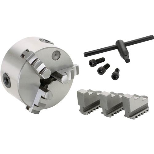

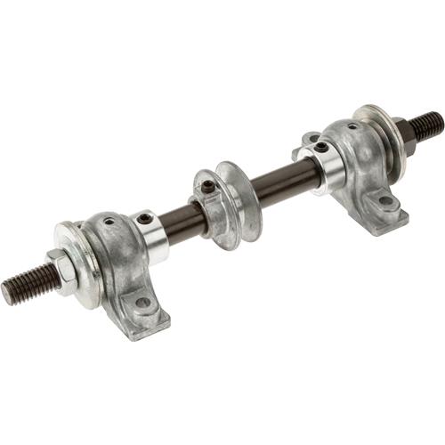

    not yet, and only kinda sorta...but I have plans!
    Bed: laid flat with a steel plate bolted for ways, some cast arms slid into the side channel for all thread for the carriage to be driven off, and a pair of uprights Id cast to hold one of these: and add a chuck to the end. I have a 1800 rpm continuous duty electric motor, and will cast some step pulleys to bring it down to 400-800 rpm chuck speed.Theres various other fiddly bits that will be needed as well, but I have a friend that has the patterns for me to use to cast them, and those he doesnt have will be easy-ish to recreate.
    This will be fun, and should be less than $100 to build (minus tooling). Im just waiting till the beginning of the year for the holiday craziness and spending to be over.
