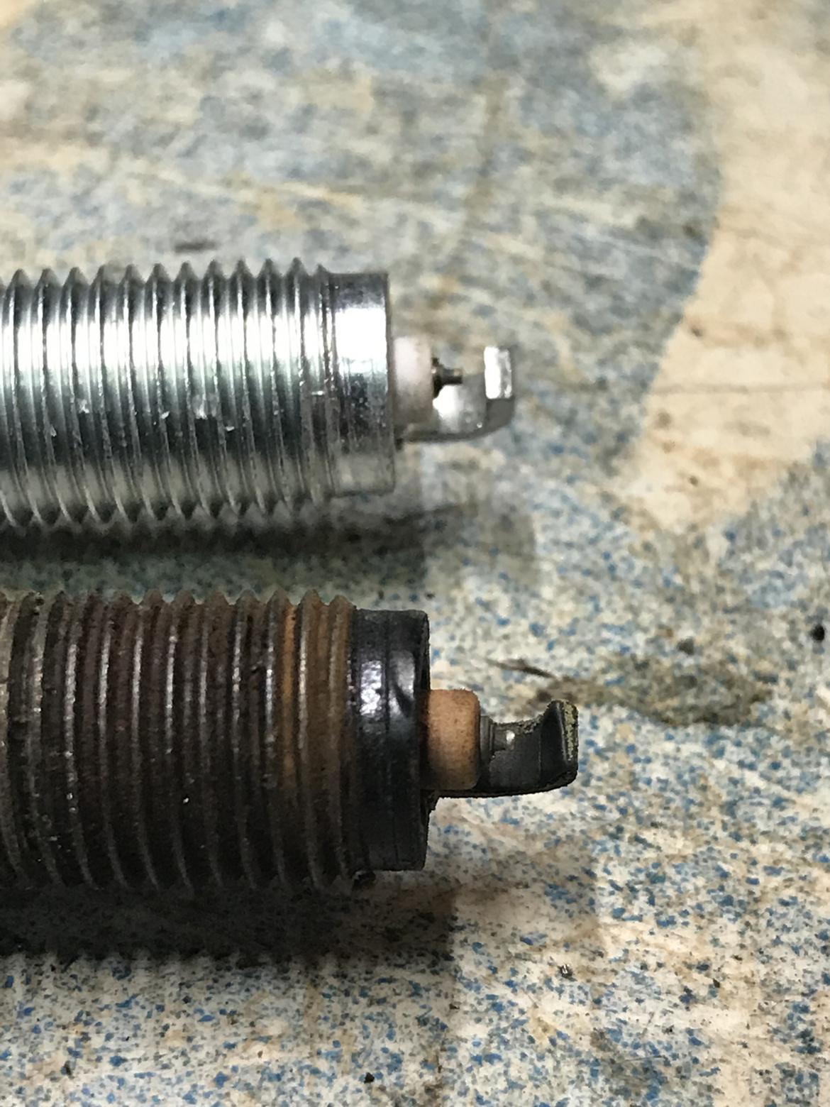

I got the plugs changed this morning. I only found one coil pack in town, so I didn’t bother repacking them. They actually still looked really good anyway.
The plugs, however:
I don't know that I’ve ever changed iridium plugs before, but I was surprised that 1.) the electrode still looked ok, and 2.) that the ground on most plugs was worn at an angle, as (barely) seen above. Is this normal?
It took me a bit less than 3-hours. Thankfully having small hands made it easier.

Good question. I’d never experienced the problem, though when SWMBO got home one evening last week it sounded like I could hear a slight miss in the exhaust.
I drove it twice this afternoon & it seemed fine, but with the herky-jerky transmission it’s difficult to tell.
