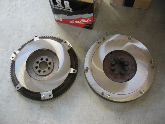

The significant difference between earlier and later 4AGE discs, and pressure plates is the earlier stuff is 200mm friction surface, while the later stuff is 212mm. Either can be used, as long as they are all matched... (all = flywheel, disc, plate) The AE86 only came with 200mm flywheels... those that were 7.2 kilos. The Silvertop and high comp flywheels are the same, 212mm, and 7 kilos. Finally is the blacktop flywheel, it is 6 kilos
Here is a photo of the blacktop flywheel and the high comp/silvertop flywheel
You can use any of the 4AGE flywheels on any other 4AGE... all use the same ring gear(gear starter engages)
