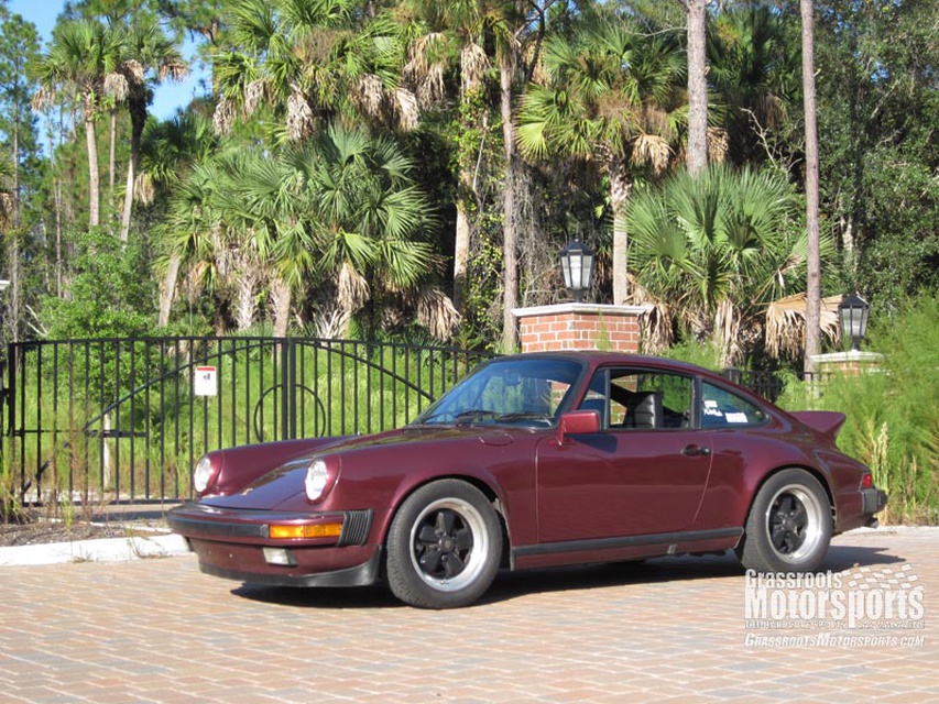

Our 1984 Porsche 911 Carrera's idle seemed kind of high. It would hover right around 1200, while the factory spec is closer to 800.
Vacuum leak? Bent throttle arm? ECU issues? Wacky airflow meter?
According to the Bentley manual, a 1200 rpm idle is a symptom of a bad idle switch. (See, sometimes it pays to read a book.)
