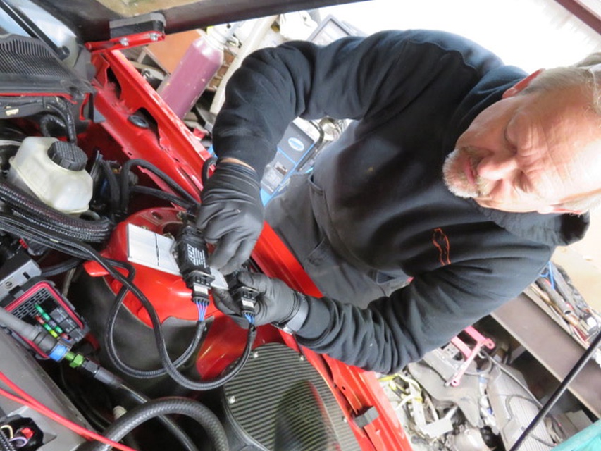

One of our big projects involving we're tackling on this Mustang is the installation of a standalone engine management system, namely the AEM Infinity. While AEM does a lot of work to get you up and running quickly and efficiently, we’re learning that replacing the powerful OEM ECU of a modern car is not as easy as it looks. However, we were in good company for the installation at the well-equipped headquarters of Very Cool Parts.
The AEM Infinity specifically designed for a Coyote Mustang comes with a “lay over” harness—literally a supplemental wiring harness that lays over the factory wiring and plugs into many of the Ford connectors. A minimal amount of wiring splices need to be made, and only a few sensors (fuel pressure and oxygen) need to be changed out to work with the AEM system.
The tricky part comes when we try to retain the “street” functions of our street-legal Mustang. Though AEM fully admits that this system is recommended for competition use only and makes no claims of suitability or legality for street use, we figured we were smart enough to make it work. The jury is still out on that one.
See, while the AEM Infinity is an exceptional engine management computer, the Ford ECU is a whole car integration system. It runs stuff like the dash gauges, the cruise control, the climate control and the anti-theft system. While we could probably live without some of those things, like anti-theft and cruise, the rest we deemed rather necessary to keep the car streetable.
The physical installation was straight forward, but somewhat time consuming. We had to install a different set of fuel rails with additional ports for pressure sensors, so we went with a set from Radium. The Radium bits are of exceptional quality and fit, and provide lots of options for mounting additional bits of hardware.
A few wire splices need to be made to ensure the fans run correctly, the fuel pump operates, and the starter engages properly—the OEM starter signal is controlled by the stock ECU as well. Aside from those, getting the engine running is mostly a matter of plugging in connectors and installing the “base” map into the AEM computer.
And that’s where we’ve left off at this point. Our AEM Infinity runs and operates the engine, and we’ve researched what needs to be done to restore some of the additional systems like a/c. The next step is actual tuning and exploration of the abilities of the Infinity. One of our favorite features is the ability to switch between preset maps on the fly, without rebooting the ECU. Rain starts to hit your windshield in grid? Just flip to the “rain” map before your next run and you’re good to go.
Stay tuned for full reports on the install and tuning of our new electronic brain.
