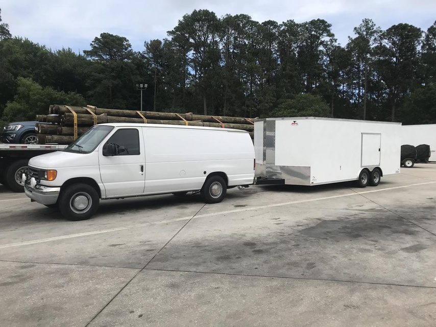

We’re working on turning this $2000 van into a do-it-all machine that can tow a car to the track, then serve as a mobile workshop and hotel room for the weekend.
Our super van was getting pretty super, especially after we upgraded the suspension so it cruised down the highway with ease. One problem: Thanks to the heat of the engine right next to our feet, our right foot would get awfully tired on highway drives. We needed cruise control to give our foot a break, but we didn't want to use a jury-rigged aftermarket system. When it comes to tow vehicles, we're big believers in retaining as much factory durability and serviceability as possible.
Fortunately, Ford made vans like ours with cruise control, and after a little homework we realized it wouldn't be too hard to add. All we'd need is the proper steering wheel, some buttons, and a new clockspring. To the garage!
