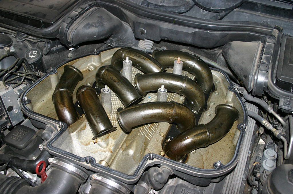

    A bit of M5 porn for you. I took the top off the intake plenum a couple of weeks ago. How cool is this?
  • pigeon
    March 28, 2011 12:22 p.m. pigeon Dork
    Sexy! First "bundle of snakes" intake I've ever seen. Just curious - why'd you have the top of the plenum box off?
  • dyintorace
    March 28, 2011 12:37 p.m. dyintorace SuperDork
    That is cool! Makes me wonder if a sweet looking clear intake plenum cover could be fabbed up!
  • Keith
    March 28, 2011 12:55 p.m. Keith SuperDork
    I'm getting a MAF error code, but the car has new BMW MAFs. I wanted to know if each MAF fed one bank or if it was a common plenum, part of troubleshooting for potential leaks. And I was curious It was only a matter of time before I pulled that plenum off just to take a look.
    we had an M5 that ran all kinds of bad with strange codes thrown, plus it was oil fouling plugs quickly so we took off the plenum cover, disconnected the MAFs and ran the engine open like that. turns out the driver's side VANOS assembly had a small oil leak and followed a passage up to the plenum where it was squirting oil all over the trumpets there. weird problem but a cool view.
  • miatame
    March 29, 2011 2:49 p.m. miatame Reader
    Is that just cosmoline on the trumpets or oil?
  • Keith
    March 29, 2011 5:05 p.m. Keith SuperDork
    Probably a bit of oil, most intake manifolds have a bit inside from the PCV system after 100,000 miles.
