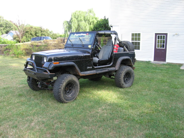

    Sorry - forgot the pics. Only took one post-lift pic thusfar.
    It is way too high. Problem is I couldn't un-do the body lift / shackle lift before I put on the suspension lift, for lack of tire clearance. Shackles should be replaced with 5/8" boomerangs within a few weeks. Body lift will be reduced to 1" via cutting of pucks and bolts. That should drop ~ 2.5" out of it and still allow clearance for 35's (or 37's?) for my next set of tires.

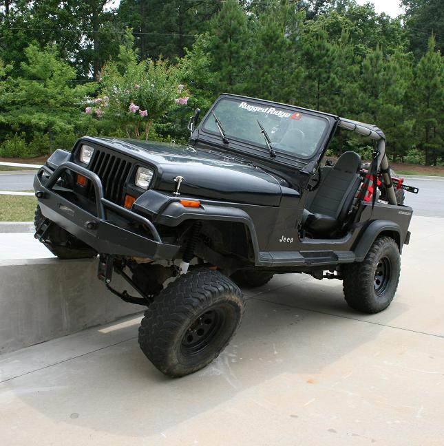

    I took it to the loading dock ramp at work to articulate the suspension and look for any binding. Once no binding was confirmed, we took it down the street to the construction site to check it in the real world. Grabbed a few poser shots while I was at it.
