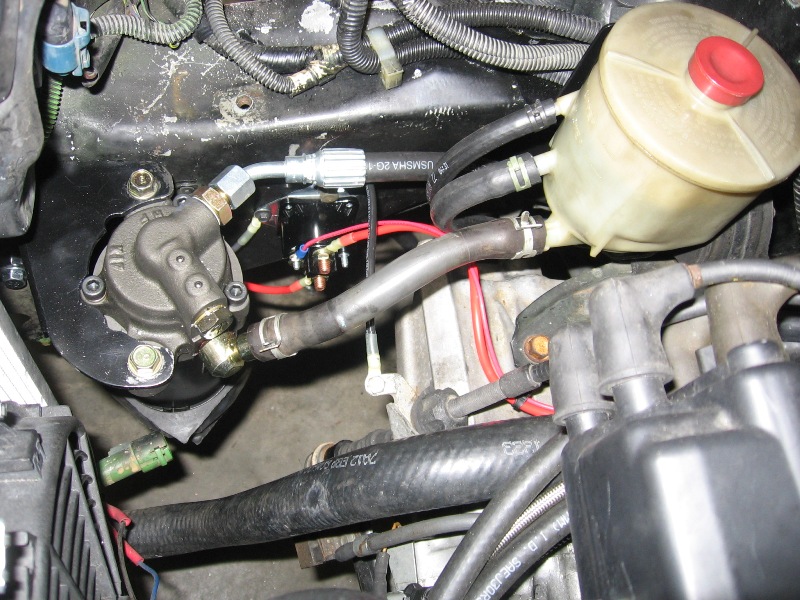

    Well, whatever the hell it's called, it is now installed on my civic, where it is used to switch the electric power steering pump.
  • WilberM3
    Feb. 28, 2011 11:23 p.m. WilberM3 HalfDork
    what electric pump is that?
  • DILYSI Dave
    Feb. 28, 2011 11:25 p.m. DILYSI Dave SuperDork
    MR2.
