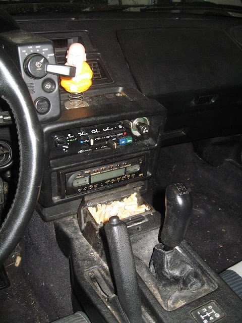

    The interior was showing its age and cigarettes:
