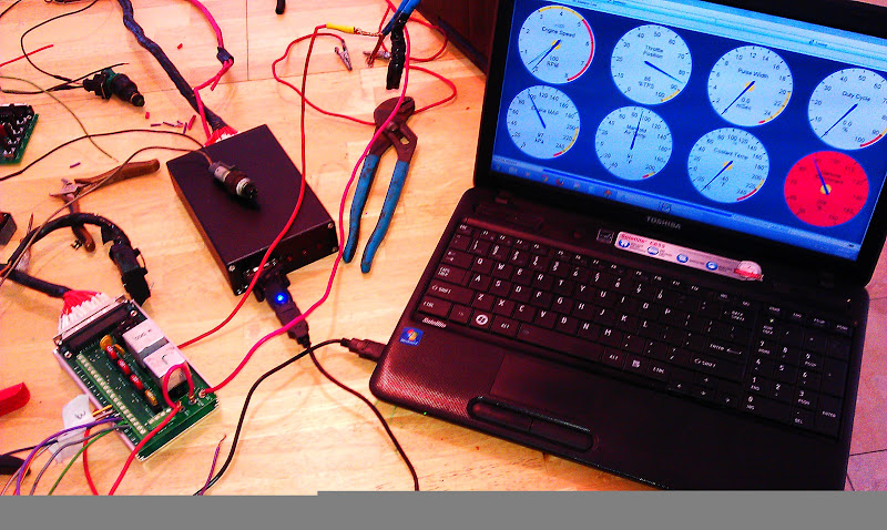

    anyway I couldn't sleep so I bench tested the dizzy... and tunerstudio picked it up perfectly... so I added the ignition portion (wow that mallory coil puts off some spark)
    so it bench tests in all aspects... also forgot I mentioned that I finally got the tps on the TB (hack saw + jb weld method)
    so I hope to get things together on the truck tomorrow and see what happens
