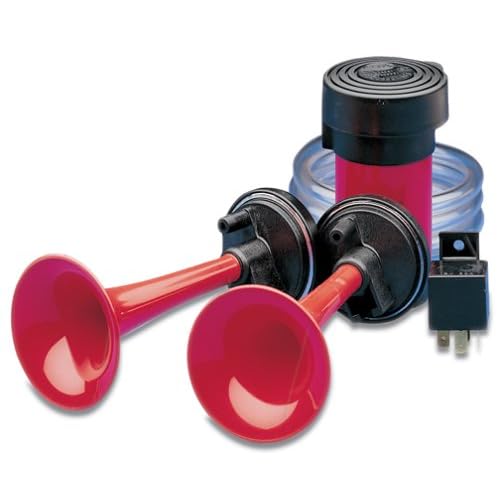

    I had a set of these. They are insanely loud and impossible to ignore. They also take up a lot less room than the twin air horn setups. The sound is not as nice , although that's probably not a huge concern on a bike.
    http://www.amazon.com/Hella-SuperTone-Horn-Kit-118/dp/B000CRZXPI

    Fiamms or Hellas are good. Remember they will draw more current than the stock horns, and you'll probably need to put in a relay to power them - otherwise the wiring and/or the horn button will melt.

    The Supertones are what you want then. The sound quality is, um, unpleasant.
    I also have two different types of the Hella air horns mounted on a couple of my cars. I love the sound, but they take up a lot more space and would look out of place on a bike. They're also cheaper.
