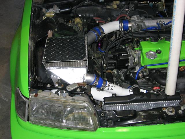

    The scoop will be in roughly the same place as this one, but larger, with the extra dimensions going toward the center line of the vehicle and the windshield.
    With the scoop that close to the leading edge, I suspect it'll benefit from some more height to it.

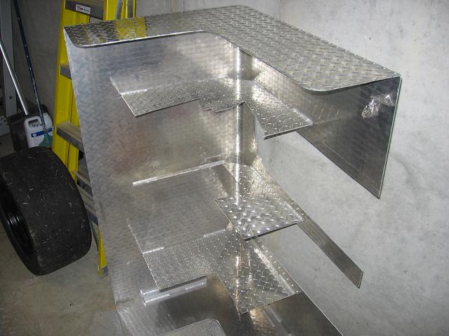

    Here is the piece of aluminum I stared with. This was part of somebody's SEMA display. We found it in the trash in Vegas and decide it looked useful, so we drug it back to Atlanta, and then during a shop cleaning I saved it from our dumpster and brought it home. Going in, I was a little concerned that it would end up looking like a piece of HVAC ducting, but I think it turned out pretty sweet in a mad max kinda way.

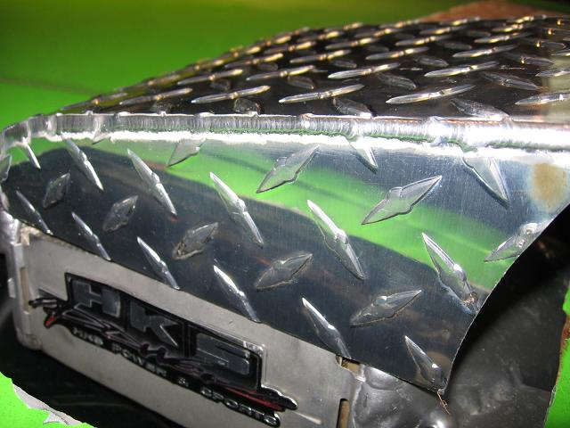

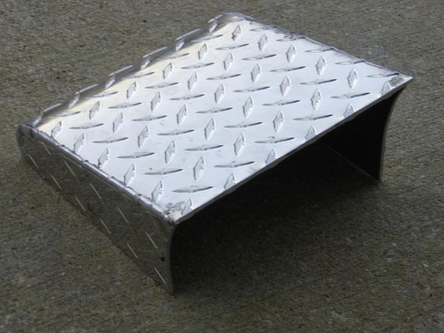

    This is after a couple of hours of cutting, welding, bending, welding, cussing, and welding. I don't really have the right tools for bending the rear return, but I made it work.

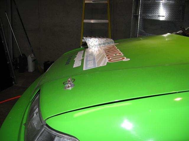

    In place...
    My aluminum welds are getting better:

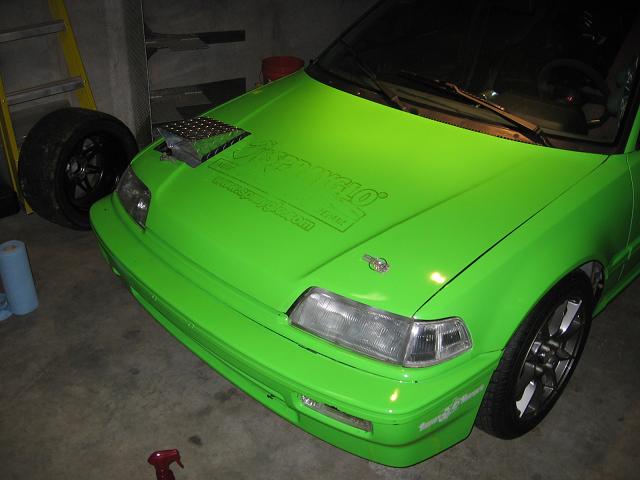

    Hood Closed:
    Hood Closed:

    edit: I see the final results... and the vote is in: Badass!

    Very nice. I never would have guessed the bend wasn't done with some sort of high end press brake. And it gets extra grassroots points for being made out of something that was thrown away.

    The bend was comical. I welded the straight portion first. Then held the part to be bent in the vice and had my wife stand on top of the work bench and put weight on the scoop to start the wrap. Then weld 1/2" or so. Then re-grab it in the vice and do it again. Rinse and repeat until the bend is completed. She was a little nervous about me welding 6" from her feet, but she's a good sport.

    what about flow thru? Where does the air go after it flows thru the IC? does it jost go bonkers inside the engine bay, or does it get routed elswhere? just curious. Looks great. Plus since its diamond plate, you didnt have to worry bout your wife slipping on it while up on the bench
    Goes bonkers in the engine bay.
