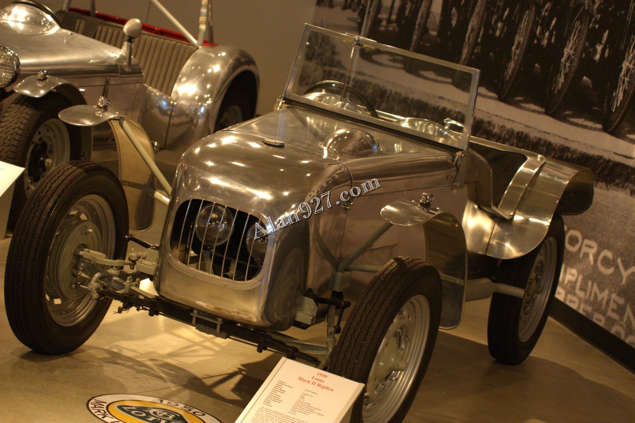

  • Dr. Hess
    Oct. 19, 2009 5:38 p.m. Dr. Hess PowerDork
    The Lotus Mark II was straight axle in front. Elevens were still solid rear axle.
