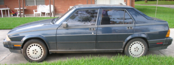

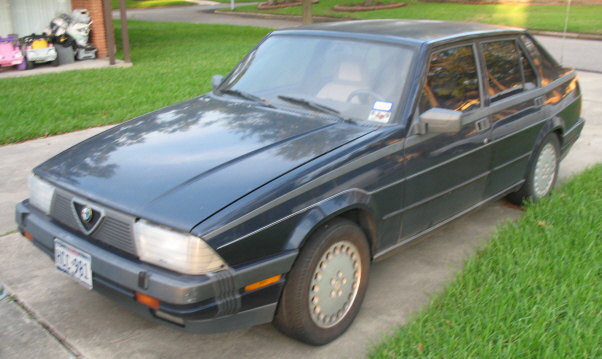

    Seller's pics. It wasn't actually posted for sale, he happened to mention it in conversation.
    I'll try to get some clear pics once I get it cleaned up.
