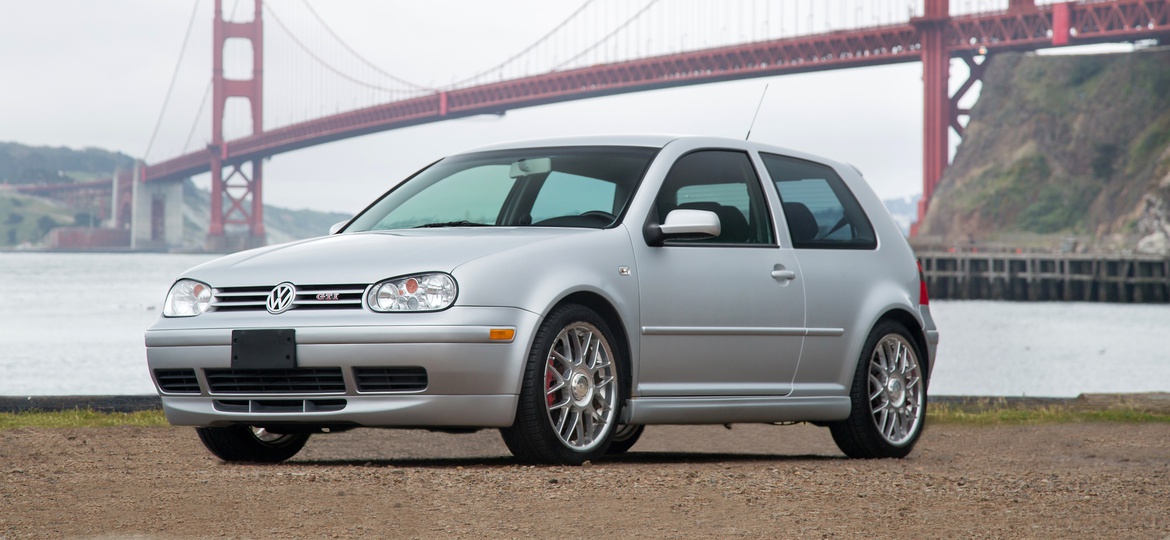

Collin Gyenes has been servicing and building fast Volkswagens with Techtonics Tuning since the early 1980s. He’s very familiar with the MkIV GTI and has some tips for our readers.
All of the MkIV cars are good, but the cream of the crop are the ones armed with the 1.8-liter turbocharged drivetrain and the 2.8-liter naturally aspirated VR6.
If you’re shopping for a MkIV GTI, you may want to focus on the state of the interior. For the first few years of that generation, the interiors are their weakest link. They don’t tend to hold up well to constant wear and tear.
For the 1.8T cars, the ones made in 2002 and later have the more desirable 180-horsepower engine. Likewise, the late-2002 VR6 cars will come with the 201-horsepower, 24-valve engine rather than the 12-valve engine. Both turbo and naturally aspirated engines are good. The turbo makes more power with modifications, but the VR6 is a very smooth, high-revving engine. You can decide between the two simply based on preference.
The 1.8T is a very good engine, but to ensure dependability it must have regular oil and timing belt changes. The timing belt is best changed between 80,000 and 100,000 miles. The plastic cooling flanges need to be changed and checked, too.
The VR6, whether 12-valve or 24-valve, needs new timing chains about every 130,000 miles. This can be an expensive endeavor for a shop to complete. The transmission has to be pulled to get to the chains.
Some of our favorite hop-ups for the turbocharged engines include an aftermarket down-pipe and exhaust. Those two pieces can get you up to 20 more horsepower. Add an aftermarket ECU and you can see another 40 to 60 horsepower. An aftermarket diverter valve is another popular upgrade.
The VR6 engine also benefits from an aftermarket exhaust (7 to 10 horsepower). Cams are another good upgrade. Both the 12-valve and 24-valve cars benefit from a cam setup of either 264/260 degrees or 268 degrees. This upgrade can net a 12-valve car 10 to 16 horsepower, and a 24-valve car can see about a 17-horsepower bump. The 24-valve cars get the most out of a 264/260 setup. A software upgrade is also good for about 11 to 16 horsepower.
If you want to upgrade your suspension, consider A-arm bushings from an R32 as well as new HD shocks and springs.
