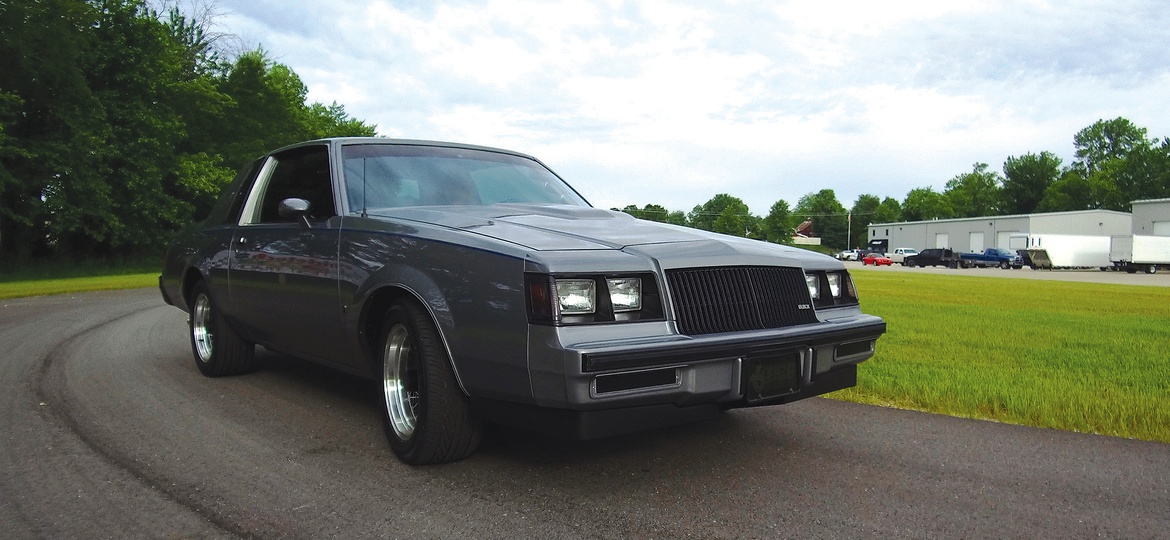

I want to build one just like that. I'll only accept 4 colors. Black, white, grey, and tan.

It's like you are reading my mind. I was just running through a G-body CAM build in my mind over the last couple days.
Coincidence or sign from the universe?

I've owned so many G-bodies its scary.  Love them.  Everybody had one but they were so cool.
Only reason I ditched my latest one (85 Elky) was because I sold it to buy Duke's 67 LeMans.

I would love a T-Type built to "Pro Touring" specs, even though the interiors were hideous even back then.
