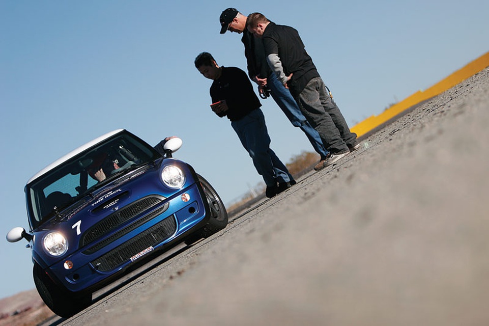

“School House Rock” might have had the cool name, but “Sesame Street” really rocked our worlds when we were youngsters. Jim Henson’s puppets combined with entertaining lessons to shape our early lives. Not only did “Sesame Street” make us laugh, but it probably helped us more than our early formal schooling. We’re even pretty sure that Bert and Ernie’s domestic …
