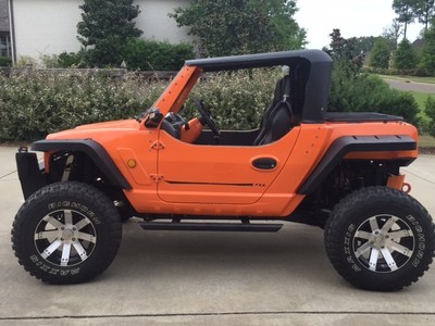

What about these?
Orieon Reeper
Street legal out of the box. 5 speed manual. Manual lockers (the levers in front of the shifter).
After my pops bought his RZR 900, I saw one of these on an ATV fun run. They are about $15k which ironically is $3k less than what he paid for his RZR.
Pete Gossett
6/16/17 6:24 a.m.
In reply to stanger_missle:
Do you know if those are street legal in all 50-states?
camaroz1985
camaroz1985 Reader
6/16/17 7:38 a.m.
stanger_missle wrote: What about these? Orieon Reeper Street legal out of the box. 5 speed manual. Manual lockers (the levers in front of the shifter). After my pops bought his RZR 900, I saw one of these on an ATV fun run. They are about $15k which ironically is $3k less than what he paid for his RZR.
How crazy, I saw one of these for sale at a local dealer on my way to work this morning. I was wondering if it was street legal. I can't imagine they would be here in PA, but maybe I'm wrong.
Going to the dealer's site it looks like they have 3 in stock, and there is a sticker on the dash that says "25 MPH Vehicle", so maybe it is street legal, but restricted to certain roads?

GameboyRMH
6/16/17 9:36 a.m.
A friend of mine has one of these and DDs it, but I haven't seem him take if off road yet. I'm not so sure about their offroad capability. You might not be able to tell from the pictures but it's a very small vehicle, much smaller than a UTV/side-by-side overall, so it doesn't have as much ground clearance or suspension travel.
