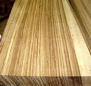

    I made one out of Zebra Wood; dense as metal, cover it with Poly.
