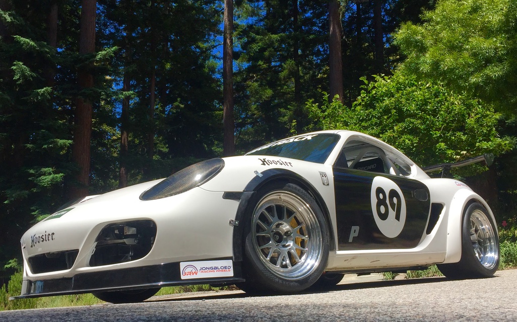

Grantsfo has knocked more than 800 pounds from this 2010 Cayman S. The goal is an even ton.

Grantsfo
Grantsfo GRM+ Memberand New Reader
1/30/18 5:21 p.m.
In reply to kb58 :
Actually this car has lots of easy weight left to pull..  Decklid skins to repace OEM trunk lid, plexi windshield, remove heater and blower system, pull e brakes, pull remaining dash structure out, drill out spot welds on front and  rear trunk floors and replace with lightweight fiberglass ,  thin out OEM wiring harness, pull all heat shielding out of rear of the car,  Go from my 24 lb  battery to a 8 lb lithium,. titanium wheel studs and nuts , Race slicks rather than heavy DOT tires,   ....However I have gone and done something crazy that adds a couple lbs.
Grantsfo
1/30/18 5:25 p.m.
....Well upgraded Garret ball bearing turbo from TPC turbo kit adds a little weight but then at 2084 lbs I could afford to add a few lbs to grab more HP.  But then 500 HP should cover that 20 lb weight gain ok.    Oh yes Porsche purists please avert you eyes.
